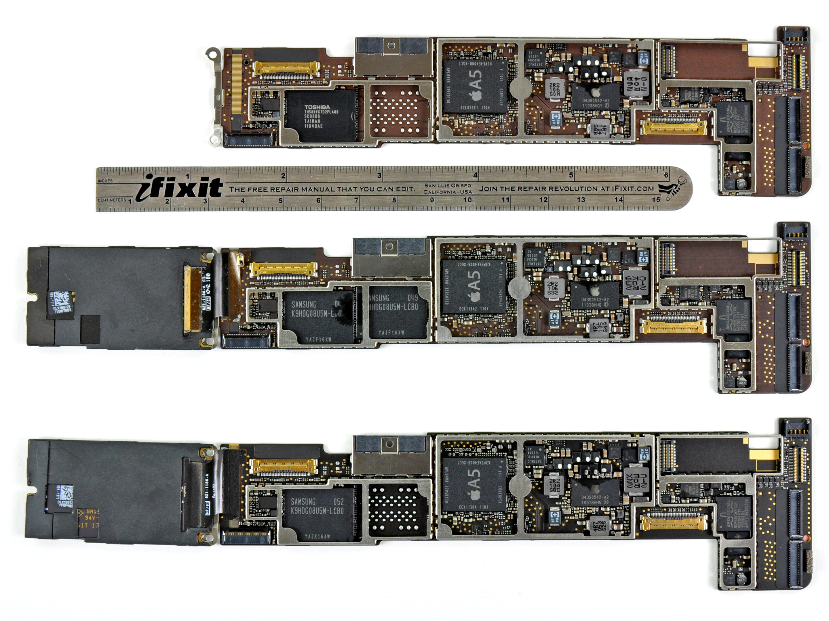

Shown here are the logic board in the Wi-Fi, GSM, and CDMA models (listed from top to bottom).
The WWAN boards on the 3G models are connected to their logic boards via surface-mounted ribbon cables.
These cables make the WWAN board not user-replaceable, as the cables securely (and permanently) attach the WWAN board to the logic board.
Big players on the GSM iPad 2 3G board include:
Intel 36MY1EF containing 128Mb of Numonyx NOR flash and Elpida Mobile DDR SDRAM.
Infineon 337S3833 Baseband Processor
Skyworks & TriQuint Transmit Modules
Infineon 338S0626 GSM/W-CDMA Transceiver
Broadcom BCM4751 Integrated Monolithic GPS Receiver; an update from the BCM4750 found in the iPhone 4.
