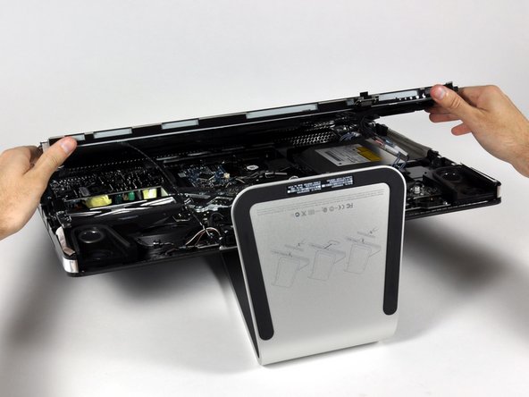

Add Note Edit Step 7  ¶
  • The display is less glossy now.
  • Twelve screws are exposed:
    • Eight 12.8 mm T9 Torx screws.
    • Four 24.6 mm T9 Torx screws.
  • The front bezel then simply rotates up. The microphone cable must be disconnected before the bezel is entirely free.

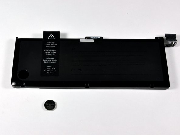

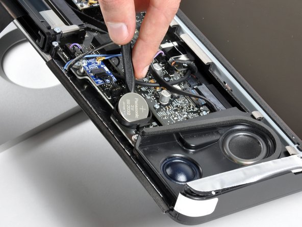

  • We wanted to see how the iMac clock battery (190 mAh) stacks up with the 17" Unibody's behemoth (12,820 mAh), so we put them next to each other:
    • 17" Unibody wins.

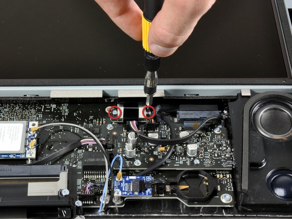

Add Note Edit Step 10  ¶

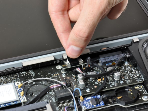

  • Most components are buried beneath the LCD assembly. This isn't a new design for Intel iMacs, but is certainly not as convenient as the rear-accessible iMac G5.
  • Unscrewing the two T6 screws securing the display data cable.
  • After removing the two screws, we pulled the connector straight up, wiggling back and forth as necessary.
Image #1 Image #2

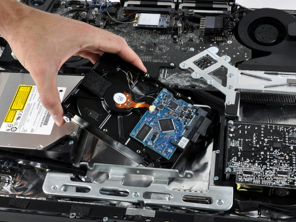

Add Note Edit Step 12  ¶
  • Removing the desktop 320GB SATA hard drive.
  • After disconnecting the temperature sensor cables, we rotated the long black clip toward the drive to unlock it, then swung it to the side.
  • We then unplugged the SATA cables and pulled out the hard drive without removing any additional screws.
  • This screw-less design for the hard drive is nice, but unfortunately getting to to this point requires removing 21 screws.
Image #1 Image #2 Image #3

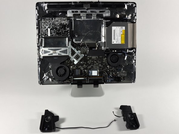

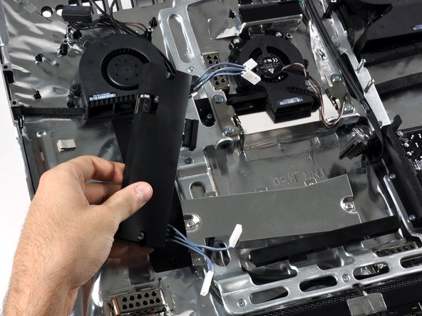

Add Note Edit Step 13  ¶

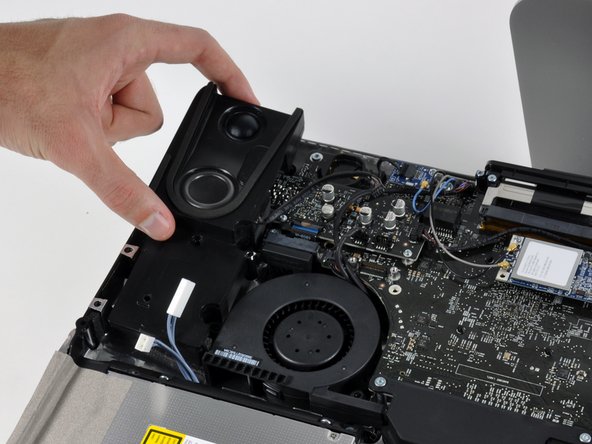

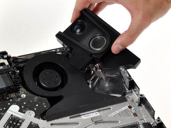

  • Each speaker is attached by one screw and one connector cable.
  • Only the right speaker needs to be removed to gain access to the logic board, but we removed them both.
  • The Bluetooth board is the blue board in the top center.
  • The 802.11n card is on the right with two antenna wires running to it from below the logic board.

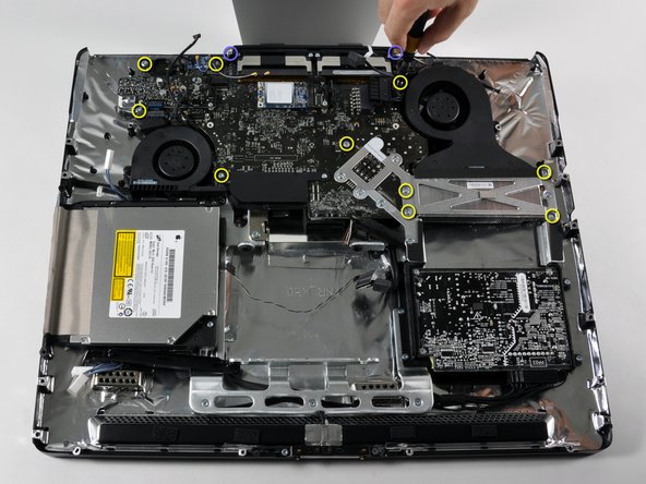

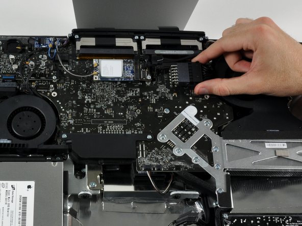

Add Note Edit Step 14  ¶
  • Removing the logic board.
  • First off, let's disconnect 13 connectors.
  • Next, we remove 10 T10 Torx screws... (Second image)
  • ...and 2 T8 Torx screws.
  • It's out! (Third image)
Image #1 Image #2

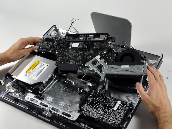

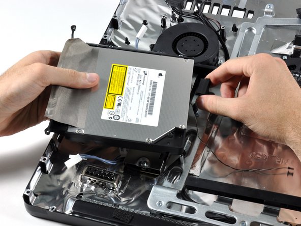

Add Note Edit Step 15  ¶

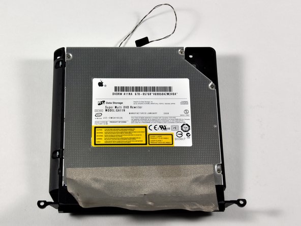

  • Apple's flat-panel iMacs have always been an interesting cross between a laptop and a desktop. This iMac features a laptop-style optical drive and RAM, but a desktop hard drive.
  • This is a 12.7mm SATA 8x double-layer SuperDrive.
  • As far as we know, this leaves the AppleTV as the only shipping Apple product with a PATA drive.
Image #1 Image #2

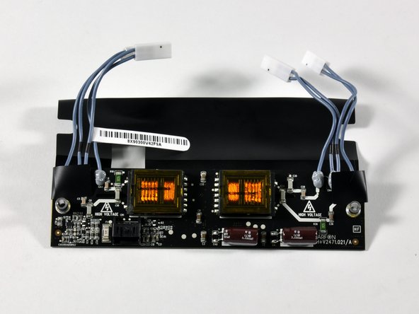

  • As we mentioned earlier, this iMac still uses an LCD with a CCFL backlight. This particular display features four backlights, each of which require their own high-voltage AC power.
  • All four are powered by a single large inverter.

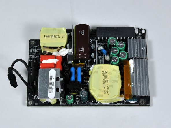

Add Note Edit Step 17  ¶

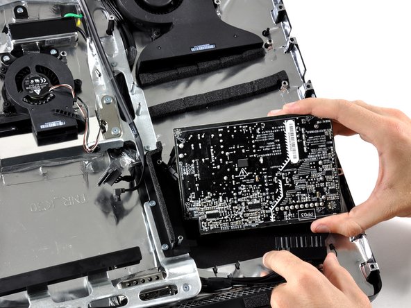

  • This is the power supply. If you're doing this at home, be very careful handling it, as capacitors can remain charged even after power has been disconnected from the computer.
  • This iMac isn't very colorful, internally or externally. However, the power supply (once removed) is surprisingly vibrant.

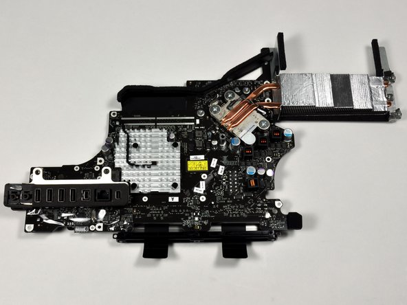

Add Note Edit Step 18  ¶

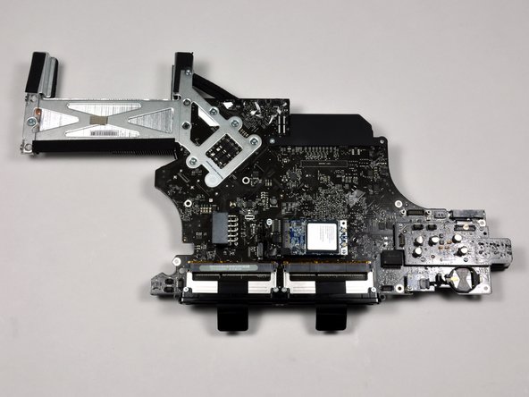

  • The large and awkward logic board.
  • The ports are all soldered directly to the logic board, and connect at a slight angle to fit the curvature of the iMac's rear housing.
  • If you want to see more detail, we have hi-res shots of the top and bottom.

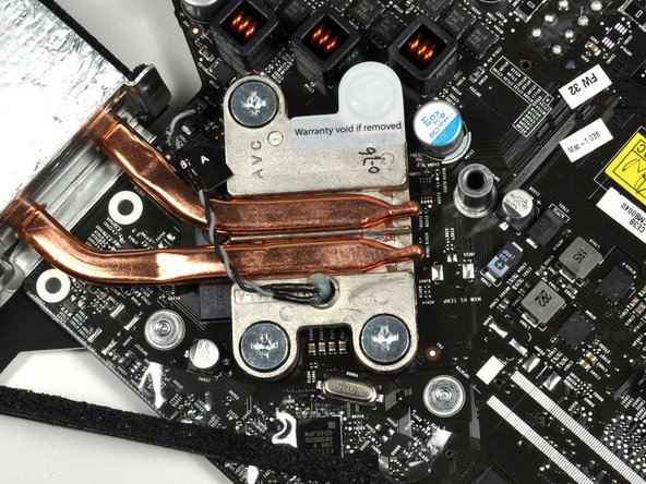

  • The heat sink directly above the 2.66 GHz Core 2 Duo processor.
  • The gray and black cable is a temperature sensor, one of at least six we've found in this iMac so far.
  • The processor appears to be socketed, but unfortunately there's a "Warranty void if removed" sticker that must be removed to access it.

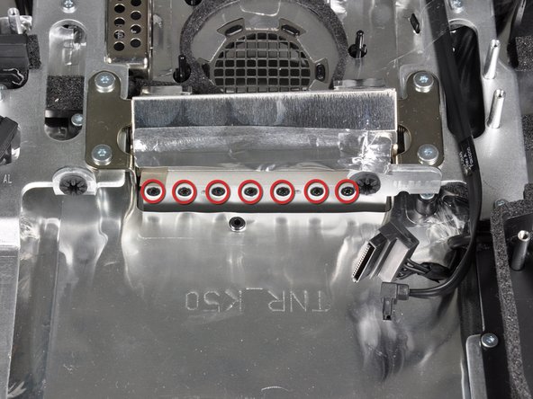

Add Note Edit Step 20  ¶
  • On the 20" iMac the stand is very integrated into the computer. Removing the stand requires you to first remove almost all internal components.
  • The stand is fastened to the housing with 7 T10 Torx screws.
  • The stand is very heavy and sturdy. Just the aluminum stand by itself weighs 33.3 ounces -- almost 70% of the weight of a MacBook Air.
