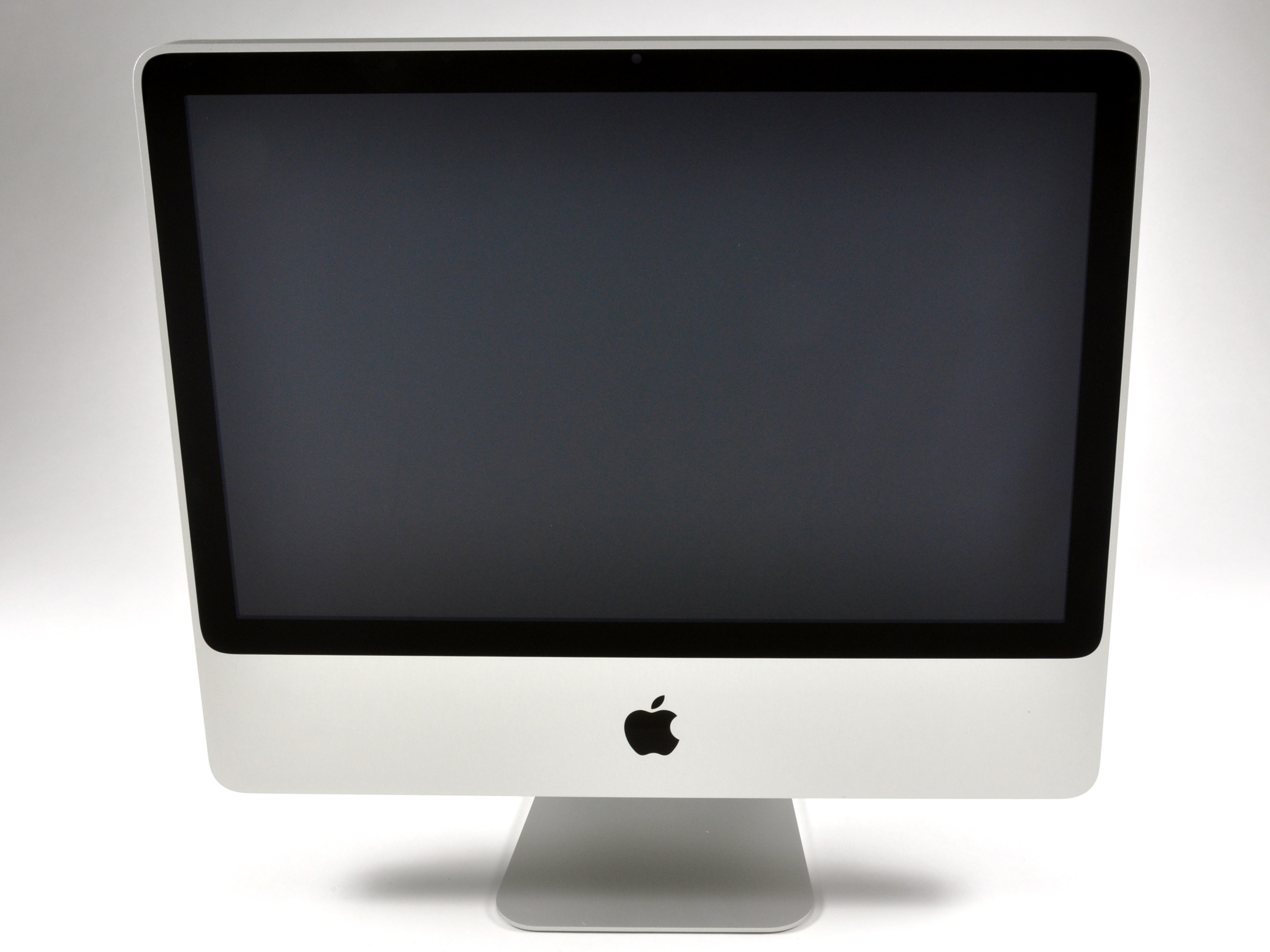

We picked up the new iMac 20" from our local Apple store on March 3rd.
Image #1 Image #2
Add Note Edit Step 1 — iMac Intel 20" EMC 2266 Teardown  ¶
  • It's here!
  • We turned it on (only briefly, of course); the LCD display is beautifully clear, even though its resolution (1680x1050) is smaller than the 1920x1200 resolution found in the MacBook Pro 17" Unibody.
  • The speakers are also surprisingly loud and clear, given that the sound seemingly comes out of nowhere...
  • Feel free to comment on specific steps as we go. We'll do our best to accommodate any special requests for pictures.

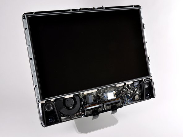

Add Note Edit Step 7  ¶
  • The display is less glossy now.
  • Twelve screws are exposed:
    • Eight 12.8 mm T9 Torx screws.
    • Four 24.6 mm T9 Torx screws.
  • The front bezel then simply rotates up. The microphone cable must be disconnected before the bezel is entirely free.
Image #1
Add Note Edit Step 8  ¶
  • It almost looks like Tim Burton joined the iMac design team...
