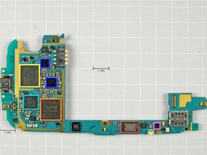

Chipworks eagerly provided us with pictures of the motherboard less than an hour into the teardown! Here is the front of the motherboard:
Murata M2322007 WiFi Module
Samsung Exynos 4412 quad-core A9 processor with 1 GB LP DDR2 Green Memory (K3PE7E700M-XGC2)
Samsung KMVTU000LM eMMC(16GB)+MDDR(64MB) NAND Flash
Intel Wireless PMB9811X Gold Baseband processor
MAX77693 and MAX77686
Broadcom BCM47511 Integrated Monolithic GNSS Receiver
33ODC 2214 4TP AC
