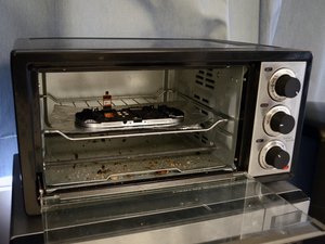

We baked our Vita in order to separate the front plastic (and fused OLED display) from the frame. Our quick recipe for frame removal:
Pre-heat oven to 200 F.
Place PS Vita front panel assembly in the oven and set timer for 10 minutes.
Remove the PS Vita from the oven and carefully peel the plastic off the front case using several guitar picks. Watch out -- it's hot!
Take 10 points back from Gryffindor.
Baking electronics: much easier than baking bread. All the ingredients are pre-mixed!
