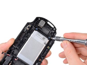

The battery is secured to the back case with a pair of Phillips #00 screws and... well that's it. There's no adhesive!
The Vita's battery runs at a standard 3.7 V and packs an impressive 2210 mAh punch.
We're confident that between the Wi-Fi, Bluetooth, 3G, 5" qHD display and two touch pads, every bit of capacity in the battery will be put to good use.
