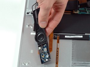

The speaker board is located beneath the arrow keys on the keyboard.
It outputs to both the 20mm speaker and the 3.5mm audio jack hidden in the drop down bay.
We found a Realtek ALC885 audio codec chip on the back of the board along with a TI TPS 62110.
