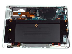

Look! We found the battery.
Unfortunately, it's no longer considered a user-installable part by Apple and is attached to the case by 9 screws:
Four 3mm #00 Phillips.
Four 3.8mm #00 Phillips.
One 7.3mm #00 Phillips.
