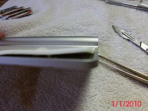

Removal of the back of the keyboard was done using a heat gun and a scalpel.
Heating the board quickly warps and destroys it.
Glue is all over the bottom plate. It was separated by pulling it apart and slicing the glue with a scalpel.
