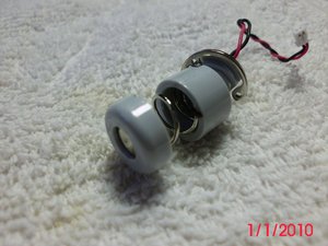

The internal battery terminal can be knocked out with a long screwdriver. It is spring loaded and held in place by a metal expansion ring.
I could not discern how the exact placement is determined as the interior of the tube appears to be perfectly smooth.
