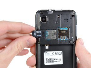

Removing the microSD card requires little effort at all.
