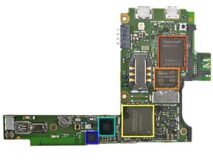

The back of the board houses:
Qualcomm MDM6200 supporting HSPA+ speeds of up to 14.4 Mbps
Hynix H8BCSOQG0MMR 2-chip memory MCP
Elpida B8132B1PB. According to Chipworks, the Elpida package contains 1 GB DDR2 RAM, but also covers the Nvidia Tegra 2 CPU/GPU residing underneath the package.
Broadcom BCM4329 802.11n Wi-Fi, Bluetooth 2.1, and FM Tuner
AKM 8975 Electronic Compass
An ultra high-res version of this picture can be seen here.
