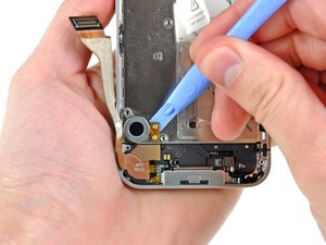

Holy haberdashery, Batman! The iPhone 4's vibrator received a complete makeover.
Rather than using a rotational electric motor with a counterweight, the Verizon iPhone appears to utilize a linear oscillating vibrator for call/message alerts. Based on the patent information around this technology, we think this may be a Samsung part.
Our tests show that the new vibrator has quieter, softer feel, and makes a better sound when on a table.
