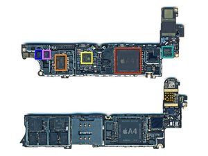

Thanks to our friends at UBM Techinsights for providing us with some chip identifications.
The front side of the Verizon logic board (on top) contains:
Apple A4 Processor
Qualcomm PM8028 Power Management
Dialog D1815A Power Management IC (Apple branded 338S087)
343S0499 - Texas Instruments Touchscreen controller - Apple/TI, part is #343S0499/#F761586G (an up-rev from earlier # F761586C of the iPhone 3GS)
SKY77711-4 - Skyworks poweramplifier module for CDMA/PCS
SKY77710-4 - Skyworks power amplifier module for dual-mode CDMA/AMPS
