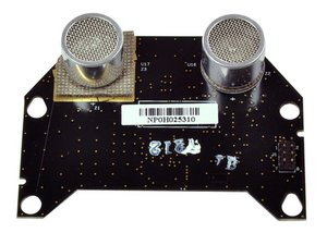

The two large mesh cylinders make up the ultrasound altimeter, which stabilizes the quadricopter within 6 meters of the ground.
The back side of the navigation board contains the Microchip PIC24HJ16GP304 40MHZ 16-bit microprocessor.
The MEMS gyroscope, the Invensense IDG 500, is also found on this board.
