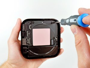

We remove the first three visible #1 Phillips screws, only to find the metal heat sink being held in place by something else.
A bit of sleuthing revealed another two #1 Phillips screws under the thermal pad. Sneaky Apple!
The other side of the cover features another thermal pad. We feel this may be a trend...
