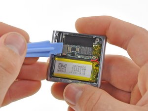

Yet another connector. This time it's for the headphone jack and power/volume button ribbon cable.
Using connectors instead of soldering greatly increases the repairability of the device. Thank you Apple.
After removing the single logic board screw, we're finally ready to pull the logic board out.
