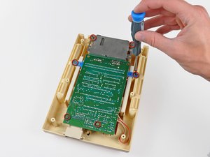

Six Phillips screws secure the motherboard assembly to the outer case.
Lifting the assembly out of the case gives us a good look at the archaic silicon that makes this thing tick.
Two more Phillips screws secure the hefty power switch to the outer case.
