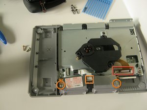

Unplug the laser assembly's power cable and ribbon cable from the main board.
Remove the two screws on the memory card/controller port, disconnect the ribbon cable, and lift it out of the case.
