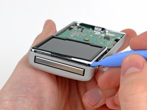

Use a plastic opening tool to carefully lift the top edge of the display out of its bracket.
It may be necessary to use a metal spudger to release a small piece of film stuck between the LCD and the display bracket.
