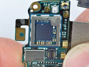

The Bluetooth and 802.11n wireless is provided by a Broadcom (BRCM) BCM4329 chip.
The 802.11n capability gives the Nexus an advantage over the iPhone 3GS, which only has 802.11g connectivity. The Broadcom (BRCM) chip in the Nexus is the same chip we found in Apple's newest (3rd generation) iPod touch.
The package is labeled BCM4329EKUBG CD0942 P21 937322 SEA
