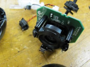

Remove the screw indicated by the green arrows
The lens can be screwed and unscrewed to adjust focus. However it is glued in place and should be reglued after adjustment
