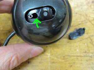

Pry off the button mounted on the side
Green arrow indicates the location of screw hole
Use a #0 Phillips head screwdriver to remove the screw
