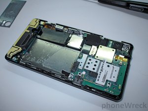

There it is!
Use the T5 to remove the last silver PCB screw.
Pull off the flex cables that fast the top of the logic board to the screen portion.
