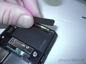

Non-conveniently, Motorola has made the chassis screws hard to find...
Two are located underneath the plastic piece at the top of the device.
Use a pin or very fine stiff wedge to lift this away from the double sided tape to reveal two more T6 screws.
