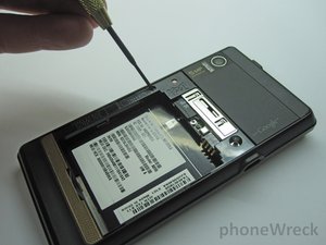

The first step is to remove the backcover and Battery
Here you'll see two screws
Use your T6 to remove both the Black and Silver Screws.
There are more screws but they are non-conveniently hidden. Finding these was the hardest part!
