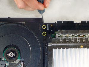

Remove the two 6.4mm #00 Phillips head black screws holding the disc drive in place.
Remove the whole disc drive by carefully tilting the lid and sliding out.
