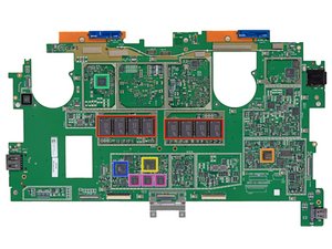

Checking out the top surface of the motherboard:
8x Micron 2LEI2 D9PXV 4 Gb RAM for a total of 4 GB RAM
Integrated Technology Express IT8519G
Atmel UC256l3U 256KB Flash, 32-bit AVR Microcontroller
ON NCP6132A 3 Phase Controller
Atmel MXT1386E Touchscreen Controller
3x Atmel MXT154E Touchscreen Controllers (the same controllers we found in the Surface RT)
Realtek ALC3230 Audio Codec
