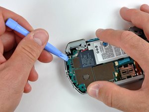

We begin our dissection by disconnecting a few connectors and removing a couple screws.
It was clear the board wouldn't come out without first removing the triggers. So we decided to start with the left trigger button.
The trigger button ribbon cables are connected to the board with ZIF connectors; a careful flick with the PSP opening tool released the clamp and freed the ribbon cable.
