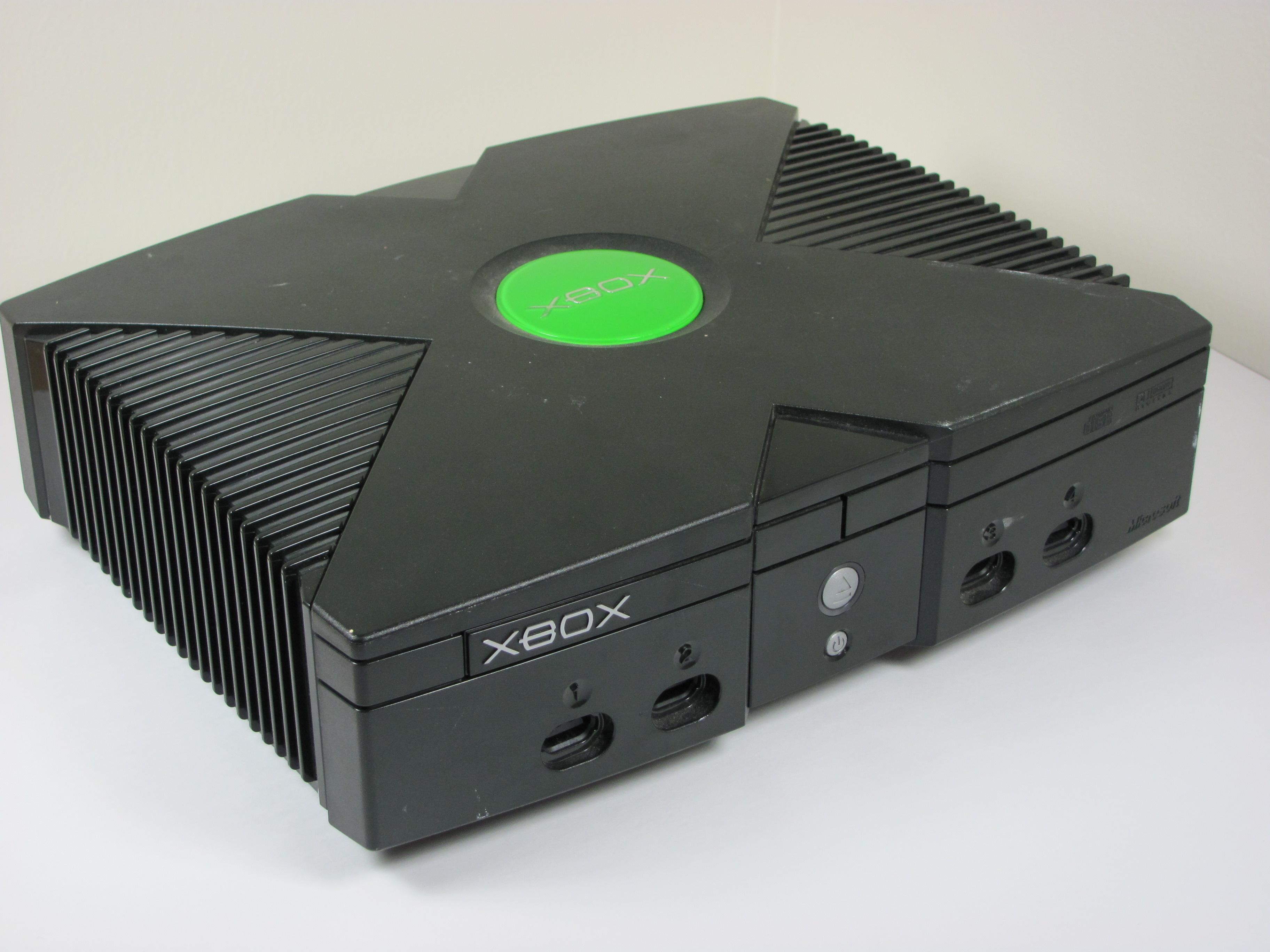

This is the teardown for the original Microsoft Xbox, not the Xbox 360.

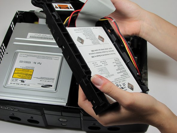

Add Note Edit Step 8  ¶
  • Lift the hard drive storage unit out of the Xbox. It should come right out.
  • Take the power cable out of the track around the hard drive so that the unit will come out easier.
