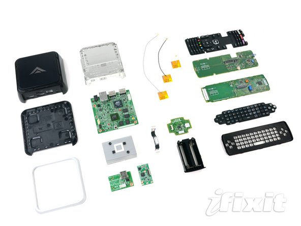

  • A little prying around the edge with a plastic opening tool, and we've got the bottom panel free.
  • Comparatively speaking, the Apple TV required two metal spudgers to open, as opposed to a single plastic opening tool here. No need to split hairs; they're both easy to open up, and we love it.
Image #1 Image #2
Add Note Edit Step 4  ¶
  • We pull off what looks like an EMI shield only to find a thermal pad sitting on top of a sea of small resistors.
  • It's not often that we encounter cooling for the back side of a motherboard, but Vizio took extra precautions as this Co-Star has no fans.
Image #1 Image #2 Image #3
Add Note Edit Step 5  ¶
  • The only thing standing between us and the motherboard are some screws and two connectors. Say hello to our little friend!
  • For those of you tuning in at home, a grand total of five screws and two cables must be removed once inside the device to free the motherboard. That's going to give the Co-Star a nice ratings boost.
Image #1 Image #2

  • And here comes the Co-Star's motherboard strolling down the red carpet:
Image #1 Image #2
Add Note Edit Step 7  ¶
  • We're used to the innards of devices being dominated by a single component, but those space hogs are usually batteries or power supplies.
    • Over a third of the real estate in the Co-Star is inhabited by the aluminum heat sink.
  • You may be asking yourself why the Co-Star has such a huge heat sink?
  • The answer lies in air movement. Without fans to circulate air, there is no forced convection. Therefore, the Co-Star must rely on conduction and natural convection to keep the processor cool.
Add Note Edit Step 8  ¶
  • We remove an additional board to reveal a whole lot of nothin' underneath.
  • The board houses the USB port and, well, nothing else.
Add Note Edit Step 9  ¶
  • We use our always-trusty spudger to disconnect the Bluetooth and Wi-Fi antenna cables from the wireless board.
  • A Marvell Avastar 88W8787 WLAN/Bluetooth/FM Single-Chip SoC brings life to what would otherwise be a very bland and boring board.
Image #1 Image #2

  • The keyboard backer sports a couple of ICs:
    • Maxim MAXQ610 16-bit Microcontroller with Infrared Module
    • Broadcom BCM20733 Human Interface Device Bluetooth 3.0 single chip
Add Note Edit Step 17  ¶
  • A few Phillips #0 screws and some prying and the lower case of the remote is gone. See ya!
  • With the case removed, we learn the screws were pulling double duty and holding the motherboard in place.
Add Note Edit Step 18  ¶
  • Yoink!
  • We grab a handy pair of tweezers and gently pluck out the trackpad data cable before removing the other board.
  • This board is powered by a Renesas R5F2133 16-bit microcontroller.
  • No flash photography, please, but this PCB does host the two IR blasters, with one conveniently on the side for the QWERTY keyboard.
