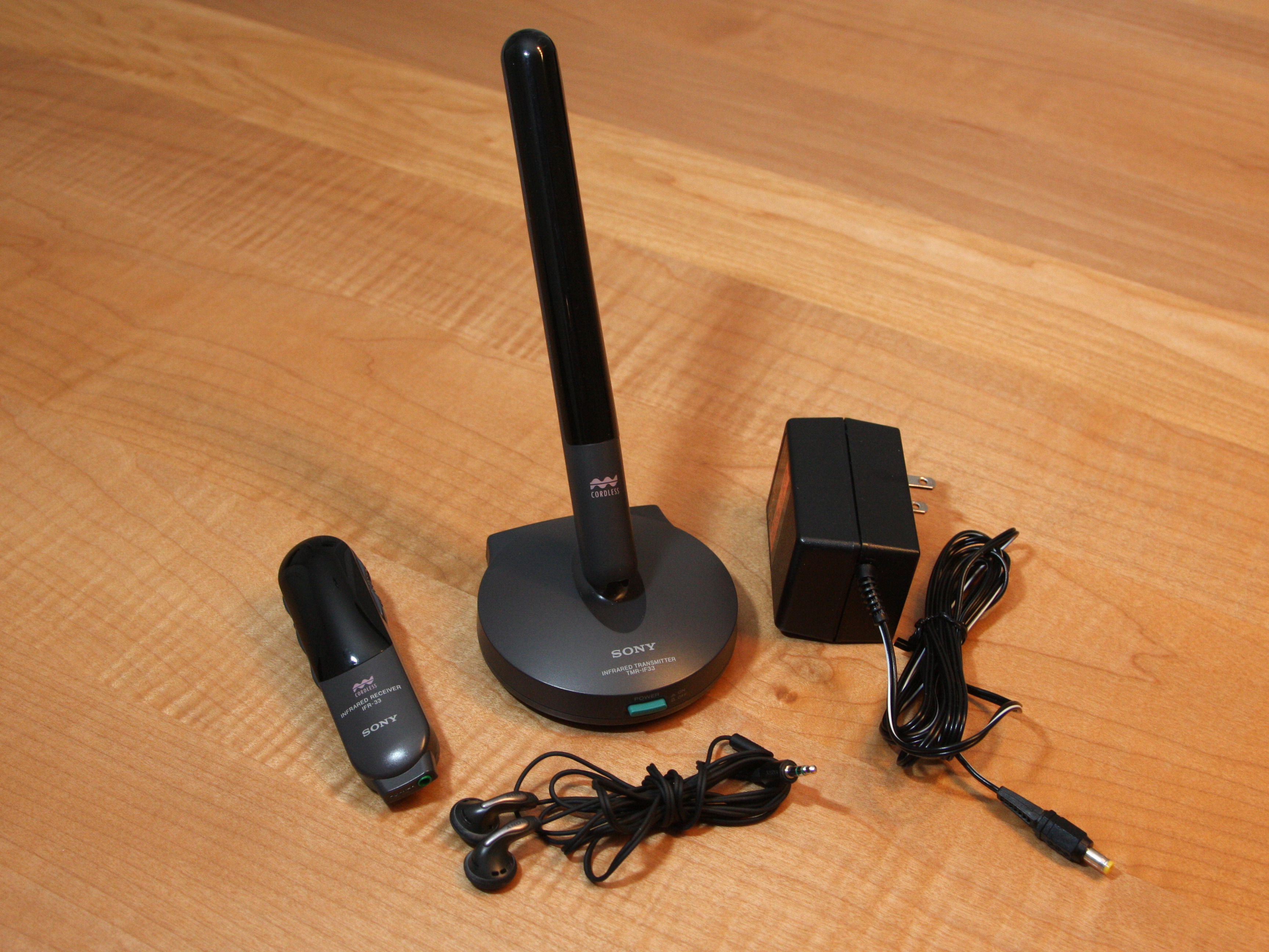

Here's a Sony wireless stereo earphone system consisting of an infrared transmitter and receiver pair, dating from around 1993. At that time, there was no such thing as an iPod and so the smallest personal audio players were cassette tape Walkmans or compact disc Discmans. With this wireless earphone kit, you could listen to your stereo, free to wander around the room without one of those 10 foot headphone cords or without a relatively bulky audio player attached to your belt.

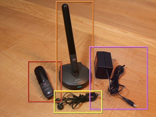

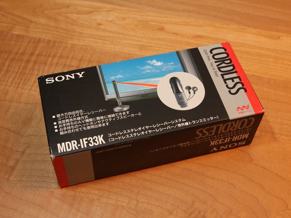

  • The main components of this kit are 1) TMR-IF33 wireless transmitter, 2) IFR-33 wireless receiver, and 3) 9V DC output AC adapter.
  • I'm not sure if this product was sold in North America, this one was purchased in Japan. In the second photo you can see the original packaging.
  • I do know that Sony used the same IR transmission system in some of its North American TVs - these components work with the wireless headphones that came with my old XBR TV.

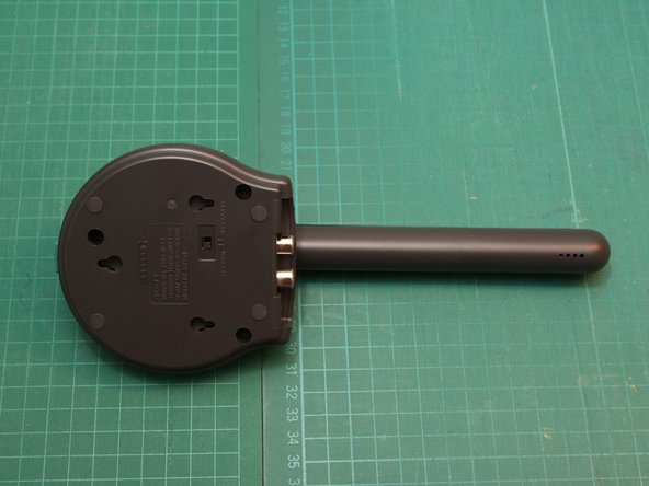

Add Note Step 2

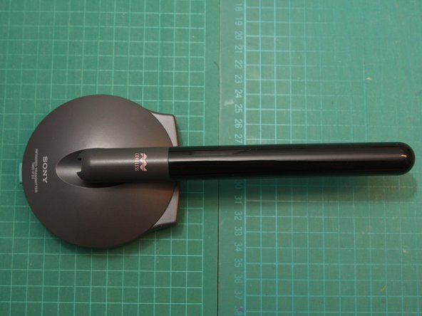

  • Here are top and bottom views of the TMR-IF33 infrared transmitter. The transmitter base holds a pivoting mast containing an IR LED array behind a dark filter/lens.
  • The transmitter has a stereo audio mini-jack input, stereo RCA jack inputs, and a 9V DC input jack. On the bottom there is a switch for normal/surround sound.
  • On the back you can see some keyed mounting holes for optional wall-mounting ofthe transmitter.
  • We'll take this transmitter apart first...

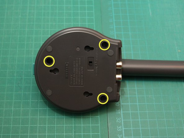

Add Note Step 3
  • First, remove the 3 screws in the recessed holes on the bottom of the transmitter using a Phillips #1 screwdriver.

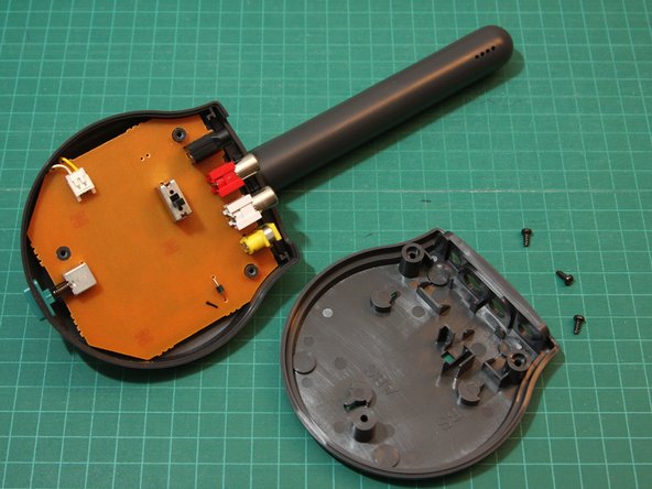

Add Note Step 4
  • Once the screws are removed, you can lift off the bottom cover.

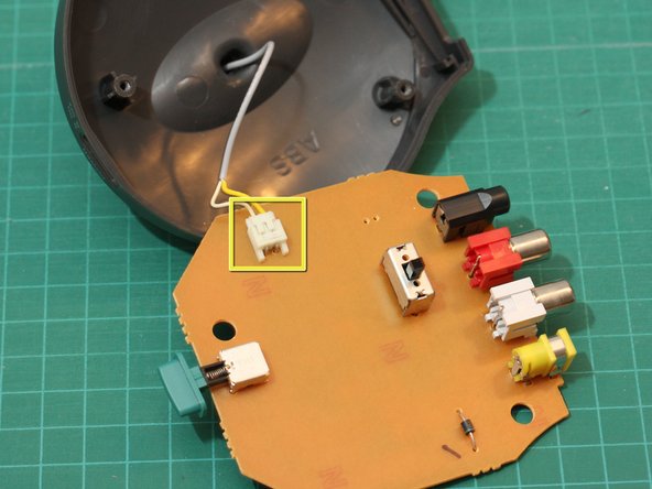

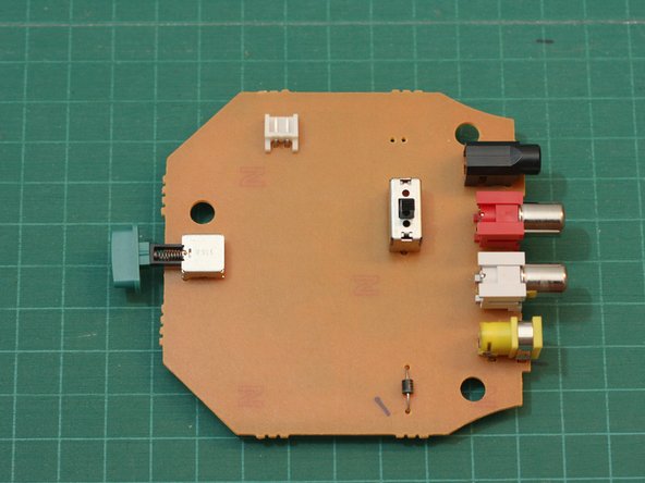

Add Note Step 5
  • Carefully disconnect the connector shown from the circuit board. The wires go to the infrared LED array, which we'll see in a moment.
  • The circuit board on this side is very plain. The green button on the left is the power switch.
  • Hopefully there's more to the transmitter circuit than that lone diode visible on this side...

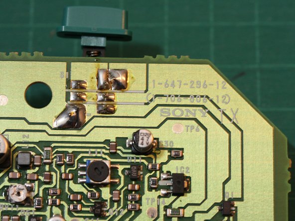

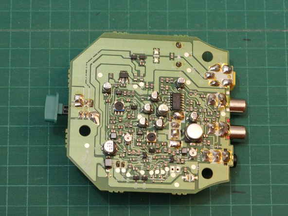

Add Note Step 6

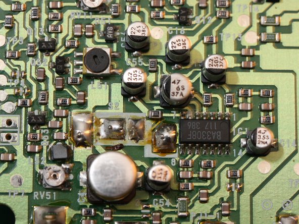

  • Here's the business side of the transmitter PCB, along with a couple closer views.
  • The transmitter consists of mainly discrete components. The lone IC in the 14 pin DIP packages is a BA3308F dual audio preamplifier.

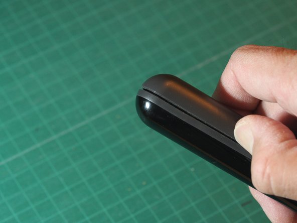

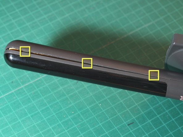

  • Next we'll open the housing for the IR transmitter array...
  • Using either your thumbnail or a spudger, carefully pry the housing open along the seam.
  • There are 3 hidden tabs on either side of the transmitter mast (see markers in 2nd photo). Pop these open carefully and the lens portion of the housing will come off.

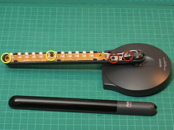

Add Note Step 8

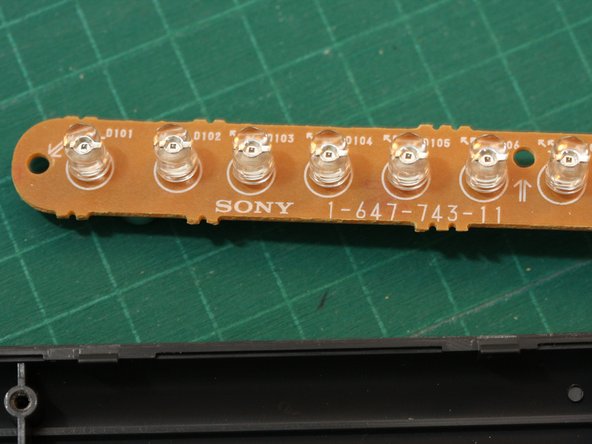

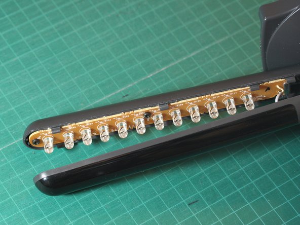

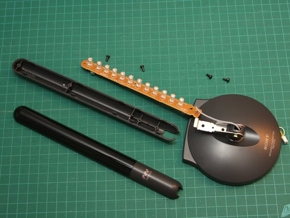

  • Here's the transmitter mast with the front lens/cover of the housing removed. Inside we see an array of infrared LEDs.
  • Next remove the 4 Phillips screws. Two of the screws fasten the metal hinge to the back half of the housing (one is partially obscured by the hinge in the first photo).
  • The other two screws fasten the LED circuit board to the back half of the housing.
  • The third photo shows a closer view of some of the infrared LEDs. There are 12 LEDs in all. They emit no visible light - but did you know? the IR beam can be seen by most camcorders and digital cameras.
  • The LEDs transmit the audio signal using FM modulation of the IR beam. The carrier frequencies used are 2.3MHz for the left channel, and 2.8MHz for the right. The specification for maximum range is 9 meters.
