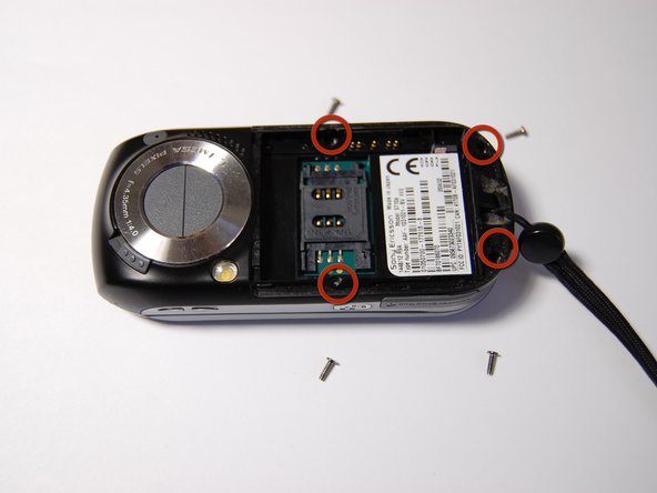

  • Remove the four 6mm screws behind the battery.
  • The battery is a 780 mAh rechargeable Lithium Ion battery.

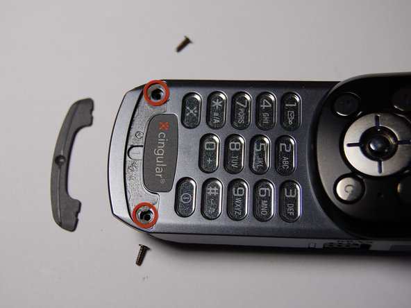

  • Remove plastic piece near the base of the keypad.
  • This will require prying it off with a plastic opening tool and breaking the seal with the glue. Unfortunately there is no way around this.
  • Then remove the two 6mm screws beneath the plastic cover with a Phillips head screw driver.
  • Now you are ready to remove the plastic back cover.

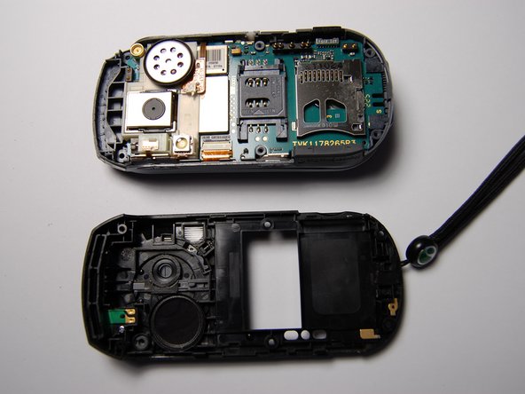

Add Note Edit Step 7  ¶
  • Use the plastic opening tool to carefully pry out the circuit board once you have removed the back cover.
first image

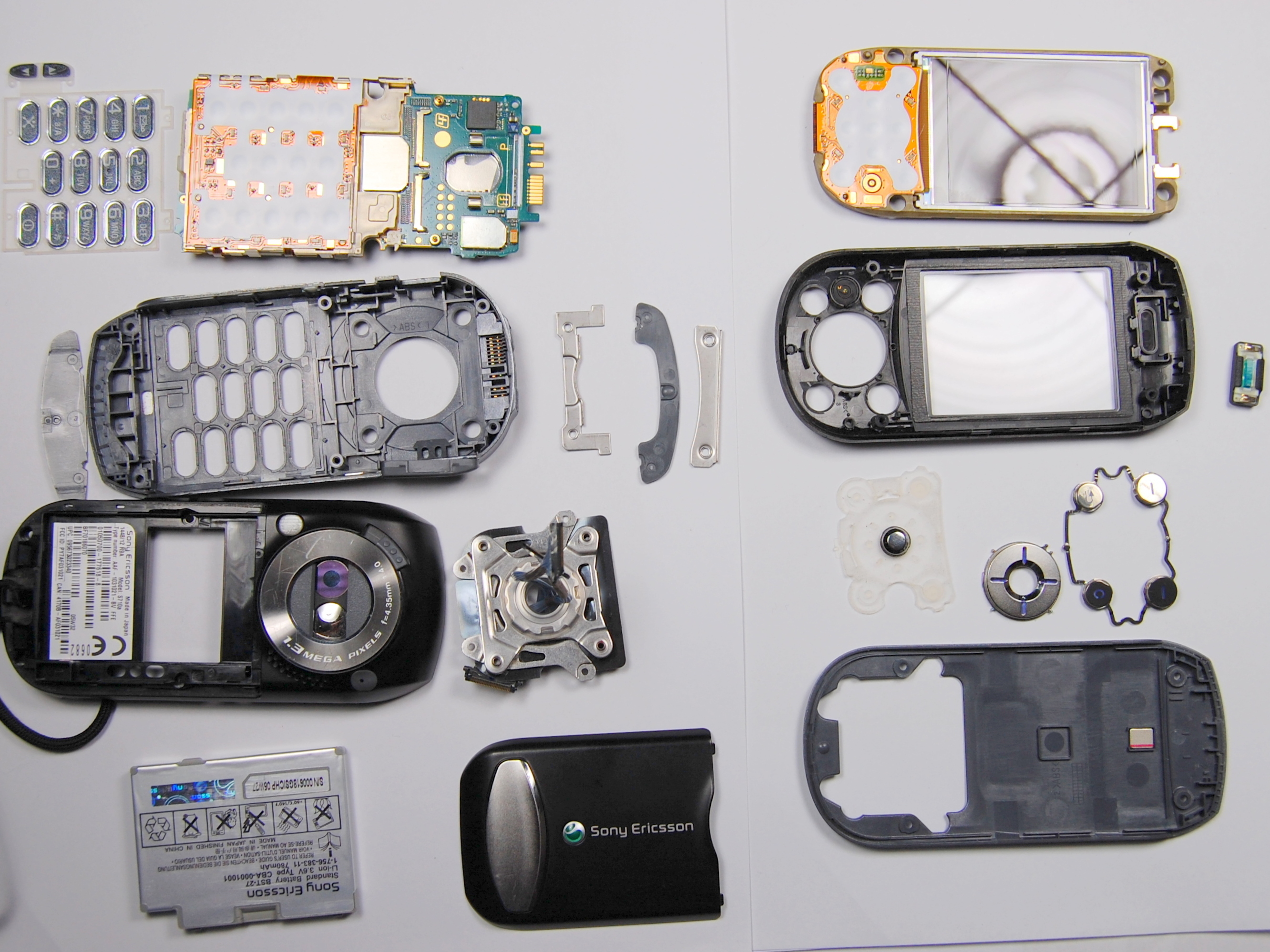

Add Note Edit Step 13  ¶
  • This phone has an array of capabilities:
    • Bluetooth
    • Megapixel Camera
    • MP3 capable
    • Messaging options
  • This photograph shows the final result of a complete teardown.
