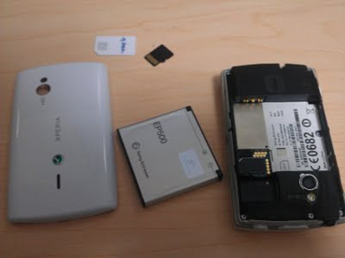

Image #1
Add Note Edit Step 1 — Sony Ericsson Xperia Mini Pro SK17i Teardown  ¶
  • Turn Off the phone :), Remove back cover, battery and simcard + sd card from the phone!
Image #1
Add Note Edit Step 2  ¶
  • Behind the battery, you will have to remove the CE sticker!
  • Remove from Sim-tray and down, it wont break.
Image #1
Add Note Edit Step 3  ¶
  • Remove 7 bolts.
  • Release clickholders, 5 pcs (green). The back should lift up from the surround.
  • Release from the bottom up.
  • Be careful around the camera, as theres a Flex cable right under it, attatched to the logicboard.
Image #1
Add Note Edit Step 4  ¶
  • Release the Flex cable by lifting the lower end off the logic board, and lift off the back assembly.
Image #1
Add Note Edit Step 5  ¶
  • Remove the logic/motherboard.
  • Push the motherboard from the keypad side, it should pop out
  • Be careful with:
    • the small clips...
    • ...and the rubber USB port plug :)
  • Start loosening the board from the end with the 2 red circles.
Image #1
Add Note Edit Step 6  ¶
  • Release Screen flexcable + lift off of adhesive under flexcable!
  • Remove 7 bolts (black ones), holding the slide/screen in place.
Image #1
Add Note Edit Step 7  ¶
  • Remove 3 bolts, top right one is covered, look carefully
  • The Green line, shows where to flick the slide off of the screen assembly!
  • Easiest way: is to flick it at the top, where you removed 2 bolts. It will come off, pretty easy.
Image #1
Add Note Edit Step 8  ¶
  • Once slide is removed, you got access to LCD and touch assembly. Easily remove the small flexcable from touch to LCD and take off LCD.
  • Only the Touch screen is left -> next.
