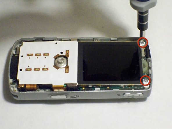

Add Note Edit Step 8 — LCD Screen  ¶
  • Remove screws holding the screen in place
first image

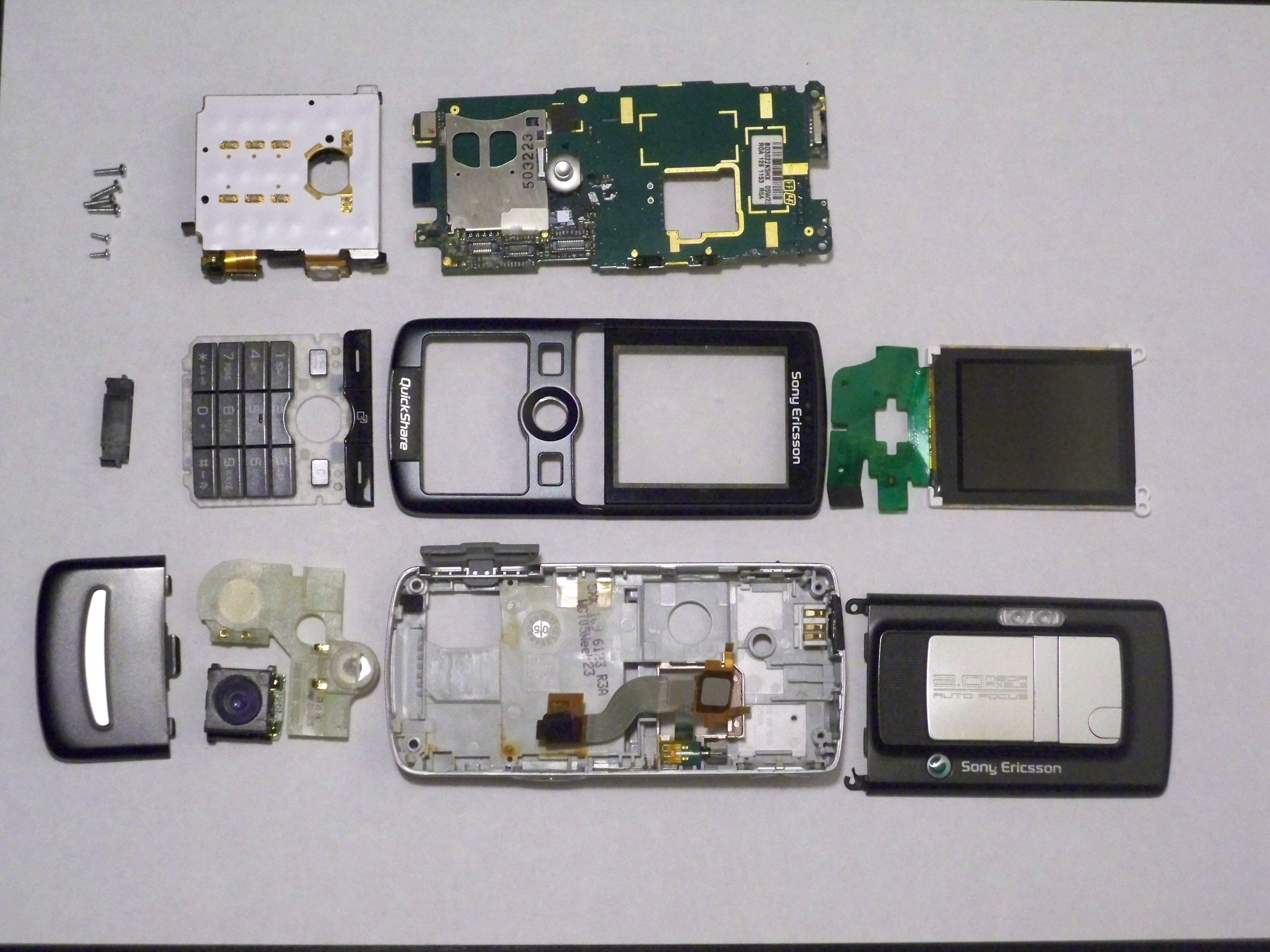

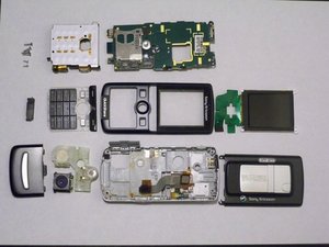

Add Note Edit Step 11 — Sony Ericsson K750i Teardown  ¶
  • Slide ribbon out of its connection
first image
thumb image 1
thumb image 2
Add Note Edit Step 12  ¶
  • Lift the motherboard out of the phone
    • Caution: Ribbon is fragile. Work motherboard off around the ribbon to prevent damage
first image
thumb image 1
thumb image 2
Add Note Edit Step 13  ¶
  • Pry off microchip below the ribbon
first image
thumb image 1
thumb image 2
Add Note Edit Step 14  ¶
  • Lift out plastic support
  • Teardown is complete
