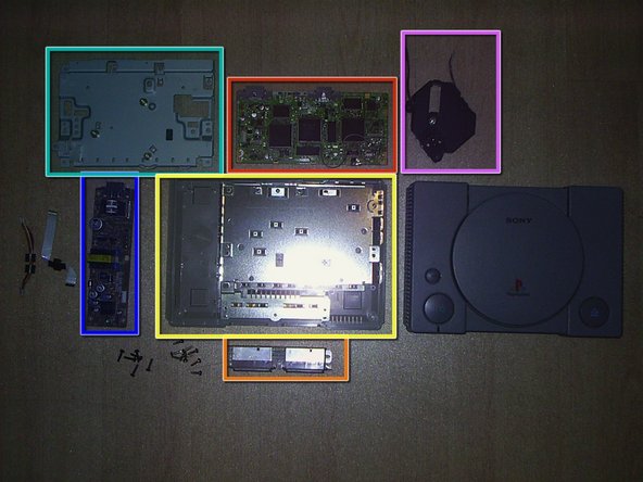

  • Here's the PS1.
  • Turn the PS1 over and remove the six screws.
Image #1
Add Note Edit Step 2  ¶
  • Remove the top cover. It's very easy.
Image #1
Add Note Edit Step 3  ¶
  • Disconnect both CD-ROM connectors.
    • CD connector one and the socket it connects to.
    • CD connector two and the socket it connects to.
Image #1 Image #2
Add Note Edit Step 4  ¶
  • Remove the CD-ROM reader. You should be able to pull it out gently, although you may have to wiggle it around a bit to loosen the rubber holders.
Image #1
Add Note Edit Step 5  ¶
  • Detach both cables. They go to the power supply and to the memory cards and controller connectors.
Image #1
Add Note Edit Step 6  ¶
  • Remove the four screws and the metal cover.
Image #1
Add Note Edit Step 7  ¶
  • Now you have the motherboard!
  • And the power supply.
  • Remove the four screws from the motherboard and the power supply.
Image #1
Add Note Edit Step 8  ¶
  • Once the screws are removed, remove the power supply.
Image #1
Add Note Edit Step 9  ¶
  • Remove the motherboard, and both of the screws from the memory card/ controller connection mechanism.
Image #1
Add Note Edit Step 10  ¶
  • Now, you have all your PlayStation 1 parts!
    • Main Board
    • Lower Casing
    • EMI Shield
    • Power Supply
    • Disk Reader
    • Memory Card/ Controller Mechanism
