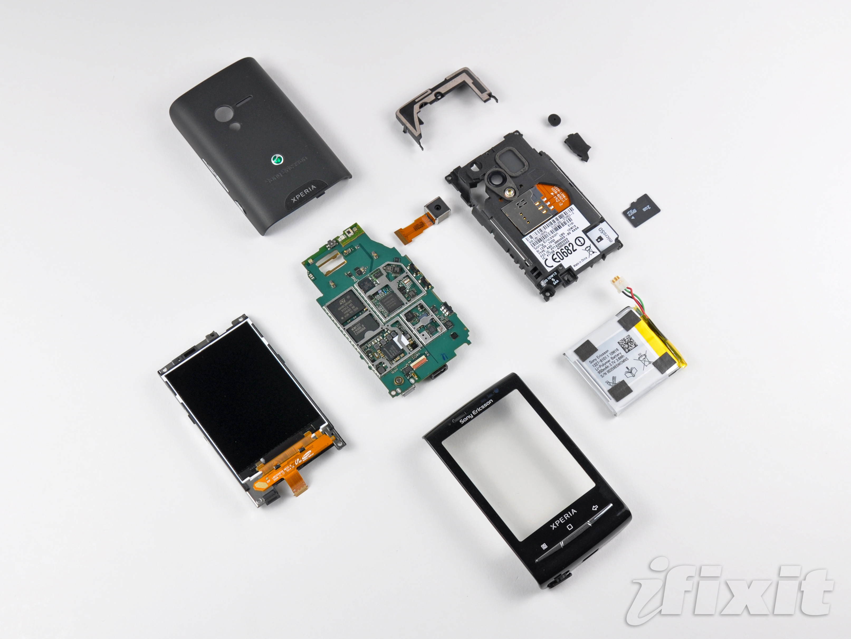

In the midst of the iPhone 4 craze, we became impatient and decided we needed to tear down a phone, you know, just to keep us in tip-top shape. And lo-and-behold, the Sony Ericsson Xperia X10 Mini E10i.

  • A few quick pries with an iPod opening tool around the perimeter of the X10 Mini E10i and the rear case easily pops off to access the phone's innards.
  • The actual electronic volume and camera buttons are attached directly to the logic board. The buttons you press on the outer case are just chrome covers.

  • A thumbnail is all that is needed to remove the microSD card from its housing in the inner case.
  • The simple design of the Mini E10 allows most components to plug directly into the logic board. The only exception is the external microSD card slot.

  • A single T5 Torx screw and a few plastic clips are all that secure the antenna assembly to the inner case.
  • The antenna assembly uses simple yet effective pressure contacts to make a connection with the logic board. No connectors necessary!

  • A couple more T5 Torx screws secure the rear inner case and logic board to the rest of the X10 Mini E10i.
  • Disconnect the battery connector from the logic board with the flat end of a spudger.
  • Pry up the SIM card socket connector and remove the rear inner case from the the logic board.

  • The 3.7V 950 mAh Li-Polymer battery allows for 4 hours of talk time.
  • Measuring 40 x 35 x 5.5 mm and weighing in at a scant 18 grams, the X10 Mini E10i's battery provides up to 360 hours of 3G standby time.
    • The batteries of both the iPhone 3GS and the X10 Mini E10i have capacities of about 53 mAh per gram.

  • The 5 MP camera, battery connector, vibrator motor, and speaker are densely packed on the logic board near the top of the phone.
  • After disconnecting the touchscreen connector, the logic board can be carefully pried out of its enclosure.

  • Rotate the logic board upward out of its cradle and use an iPod opening tool to disconnect the display data ribbon cable.
  • The shields covering the majority of the chips housed on the logic board protect their sensitive circuitry from electromagnetic interference.

  • Big players on the board include:
    • A Qualcomm MSM7227 with 600 MHz application processing, 400 MHz modem processing, hardware accelerated 3D graphics, integrated Bluetooth 2.1 & GPS capabilities, and image/video encoding & decoding.
    • STMicroelectronics NANDCBR4N9
    • Skyworks SKY77336 GSM power amplifier module
    • Qualcomm PM7540 power management IC
    • Qualcomm RTR6285 UMTS RF transceiver with receive diversity and GPS
    • TriQuint TQM679002A WLAN Power Amplifier

  • Further prying around the perimeter of the front panel assembly allows the LCD assembly to be separated from the front panel.

  • The digitizer is manufactured by Synaptics, with the main touch screen controller labeled as T1021A 1 0942 AC0P876.
  • Interestingly enough, this is similar to the digitizer found in Microsoft's Kin Two.
  • A Samsung LMS255GF02 takes care of the Mini E10i's display needs.

  • And just like that, the dark deed has been done.
  • Thanks, Sony, for keeping it simple.
