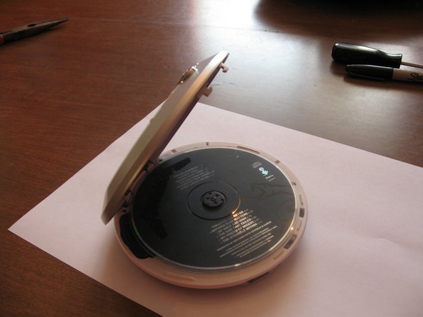

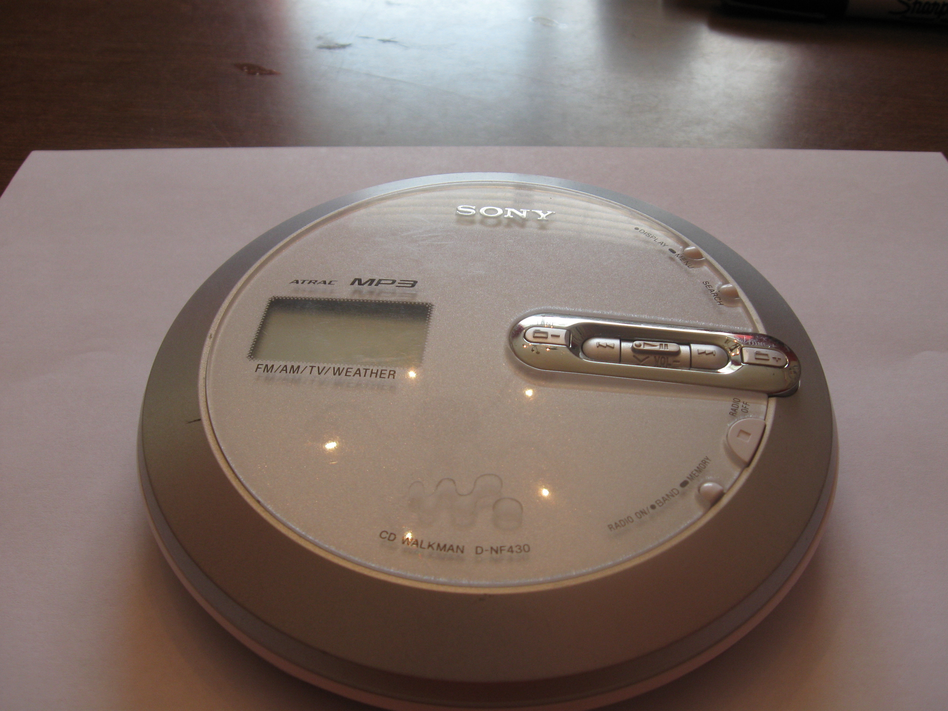

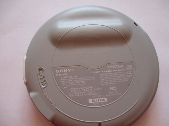

  • Start by looking at the fine detail of the exterior.
Image #1 Image #2 Image #3
Add Note Edit Step 2  ¶

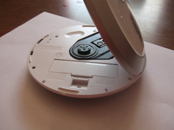

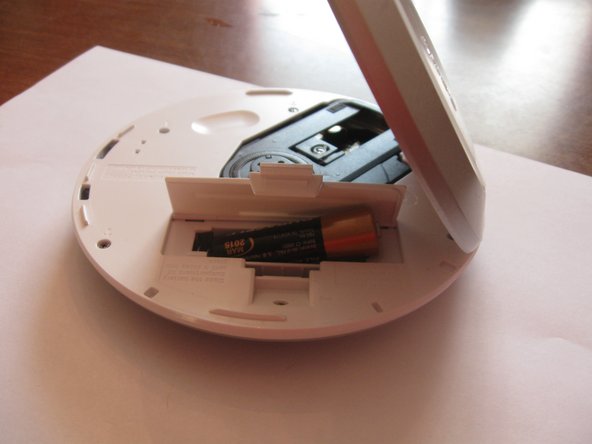

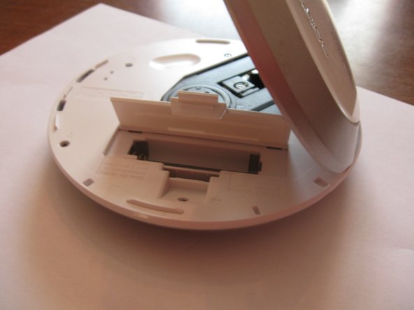

  • Open it, remove any CDs and put away. Open the battery cover and remove the battery.

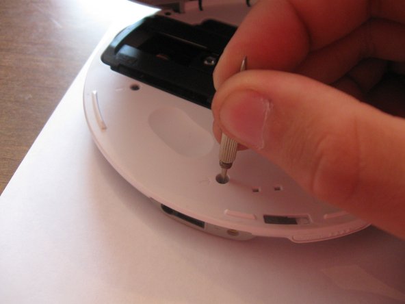

  • Unscrew the six screws and place them on the magnet so you'll be able to find them later. Sony was nice enough to put the screws next to the lid at an angle so you can fit a screwdriver in there.
Image #1 Image #2

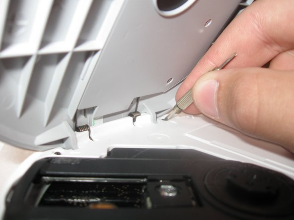

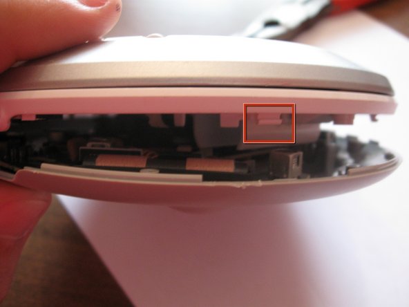

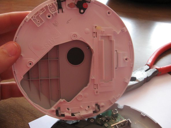

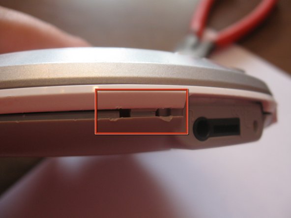

  • Insert the tip of a screwdriver between the white upper layer and the gray lower layer. Carefully pry apart. There are small clips that help hold the two layers together and you don't want to snap them.
Image #1 Image #2

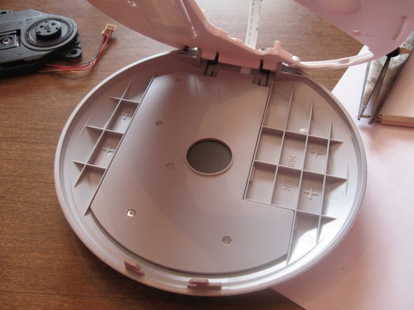

Add Note Edit Step 6  ¶

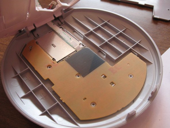

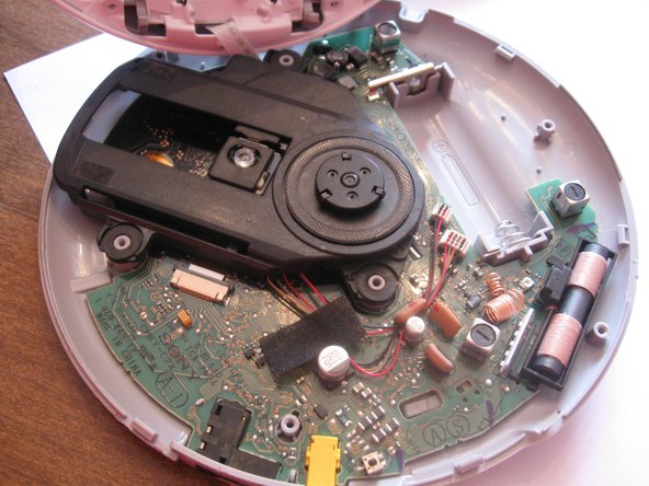

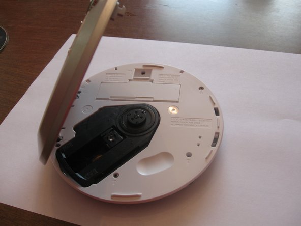

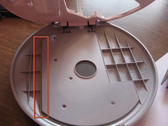

  • Here's the inside of the bottom layer.

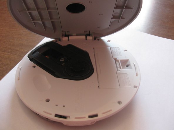

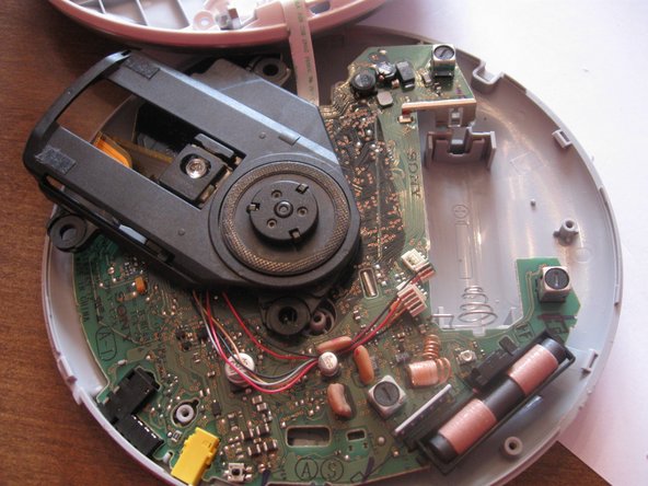

Add Note Edit Step 7  ¶

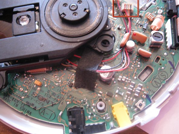

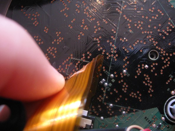

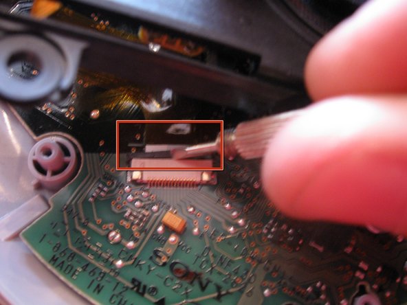

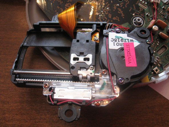

  • Now to remove the laser reading assembly. Carefully peel the orange data ribbon off the circuit board to the plug. Using the flat screwdriver, pry the black clip away from the tan part.
Image #1 Image #2
Add Note Edit Step 8  ¶
  • Now for the power wires. Pry up on the side opposite of the wires.
Add Note Edit Step 9  ¶

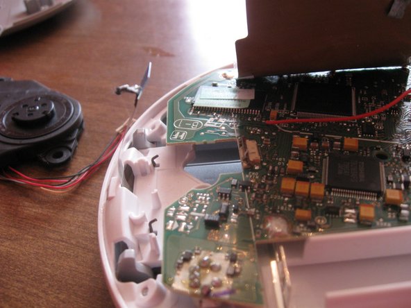

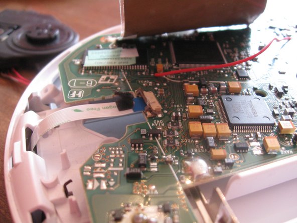

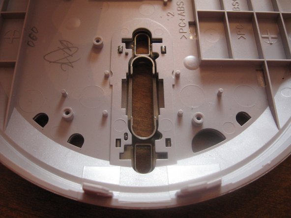

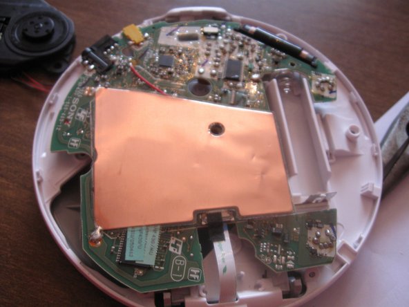

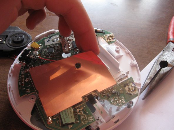

  • Now for the other side. Carefully peel up the antenna plate so you can get at the other data ribbon.
Add Note Edit Step 10  ¶

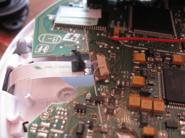

  • Peel the black tape off the plug. Pry up with a screwdriver on the brown clip and remove the data ribbon.

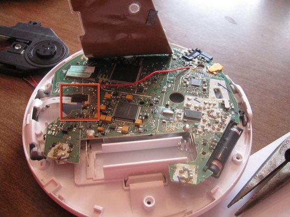

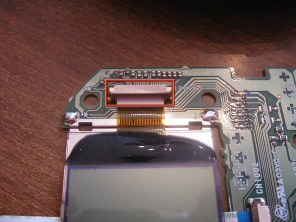

Add Note Edit Step 12  ¶

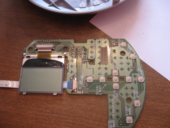

  • Pull out the circuit board and LCD screen assembly. Pry up on the brown clip to remove the LCD screen.
Image #1 Image #2

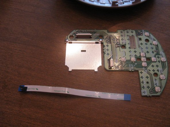

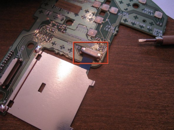

Add Note Edit Step 13  ¶
  • Now you can remove the data ribbon by prying up on the brown clip.

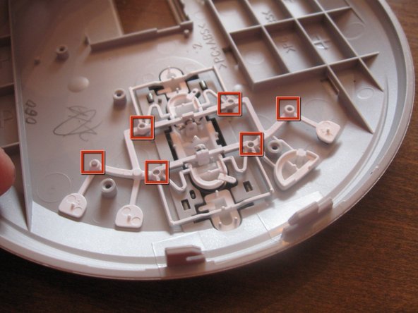

Add Note Edit Step 14  ¶

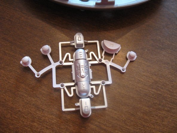

  • To remove the buttons, carefully pry up around the little pins and pull up.
Image #1

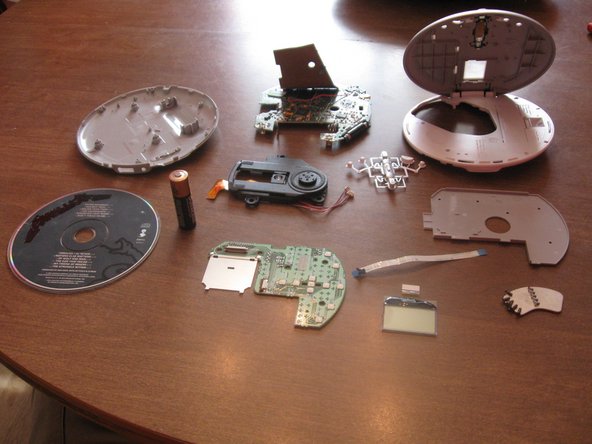

  • You're done! You have taken this CD player apart and broken it down into its individual components. Now to put it back together.
