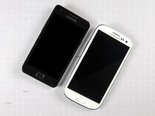

    • Pictured here next to the Samsung Galaxy S2 (left) for comparison.

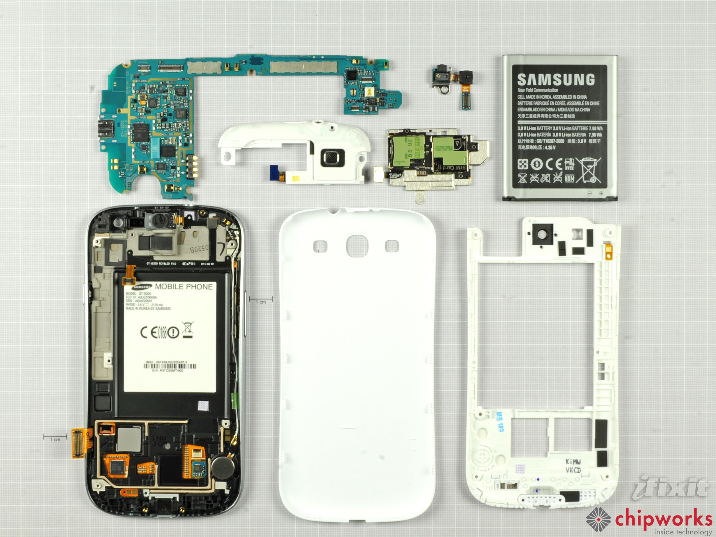

  3. Samsung Galaxy S III Teardown: step 3, image 1 of 2 Samsung Galaxy S III Teardown: step 3, image 2 of 2

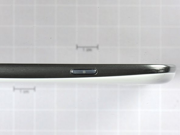

    • The simple, sleek design of the newest Galaxy S implements a standard power/sleep button on the side of the device.

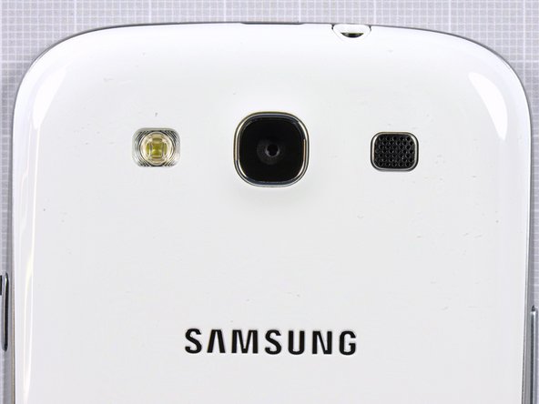

    • As we ready ourselves to dig into this Galaxy S, it watches us with its rear 8 MP camera. To the left and right of the camera are the flash and speaker assemblies.
    • The Galaxy S is not only watching us, but listening, as well.

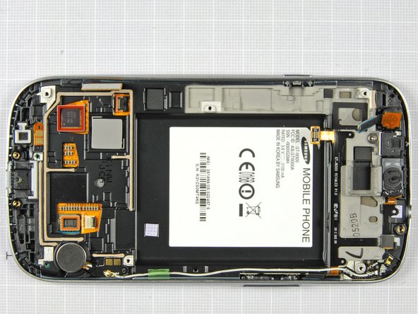

    • Much like in the Galaxy Nexus, we find a user serviceable battery in the Samsung Galaxy S III.
    • The 3.8 V, 2100 mAh battery incorporates the antenna for the Near Field Communications (NFC) module used in "S Beam".
    • For those who are curious, 2100 mAh is equivalent to 7560 Coulombs of charge. Unsurprisingly, this is the same amount of charge that a 3.8V, 7.98 Wh battery holds.
    • Well this is interesting. It would seem Samsung wants us to "refer to [the] manual before using [the] battery?" Yeah, like that's gonna happen...

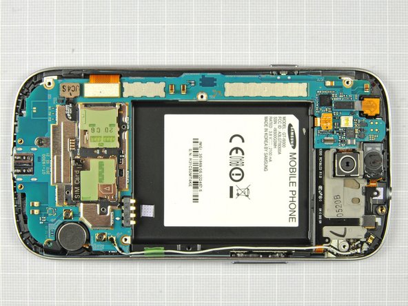

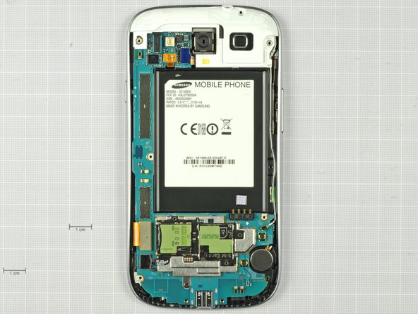

    • Internals time. The spudger takes care of the first two plastic assemblies.
    • The first piece out is the rear plastic frame that protects the motherboard and houses a single liquid indicator sticker.
    • Removal of the frame grants us access to an easily replaceable speaker assembly.

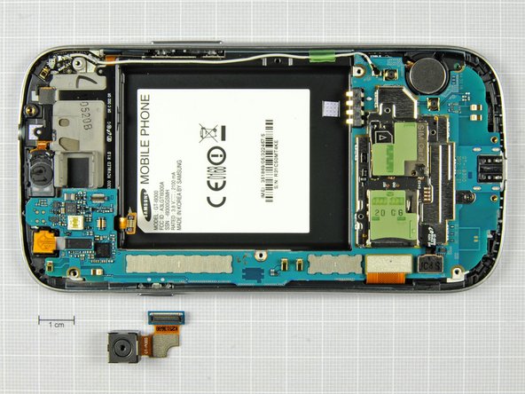

    • The big question now is what we should remove first. So many components in such a small volume!
    • Rear-facing camera you say? Sure, let's pry that 8 MP behemoth of a camera out from the inner framework.

    • We continue by removing the motherboard from the inner framework.
    • With the motherboard out of the way, we can get a good look at the inner support frame. While we suspect that the frame is probably magnesium, we do not yet have any concrete proof.
    • We find a chip that isn't attached to the motherboard: a Melfas 8PL533 Touch Sensor that translates your touch inputs into zeroes and ones.
