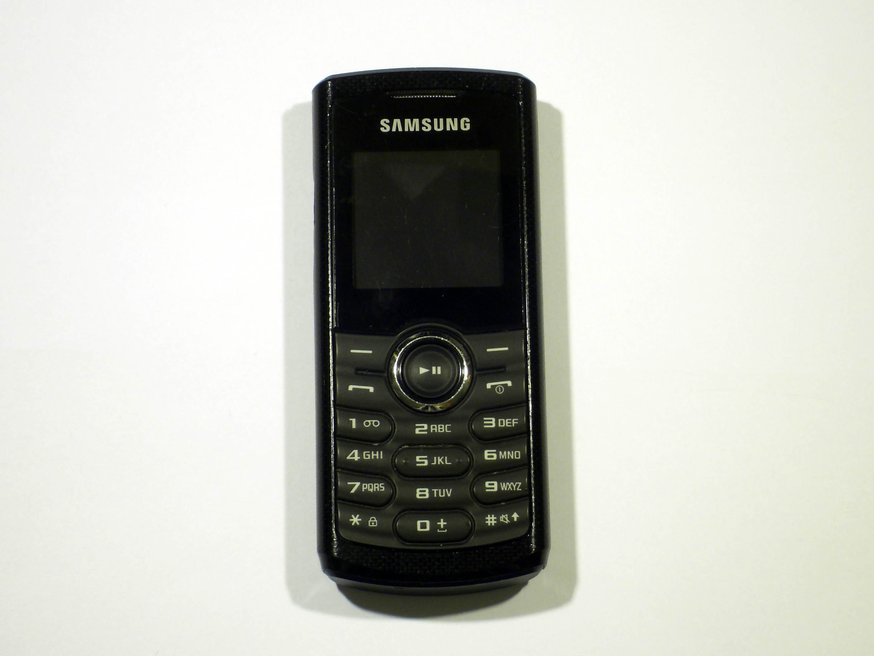

Add Note Edit Step 1 — Samsung GT-E2120 Teardown  ¶
  • Here it is! The Samsung GT-E2120. Its not very exciting, but lets crack it open anyway!
  • Whenever opening a device its always goo to ground yourself!

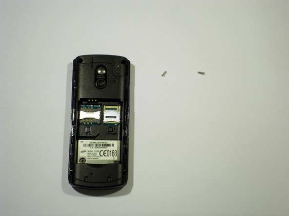

  • First on the check-list is to slide open the back cover.
  • Then the battery was taken out along with the sim card and Micro-SD card
  • This phone can take up to a 2GB Micro-SD card and is great for storing music. It even has a FM radio!

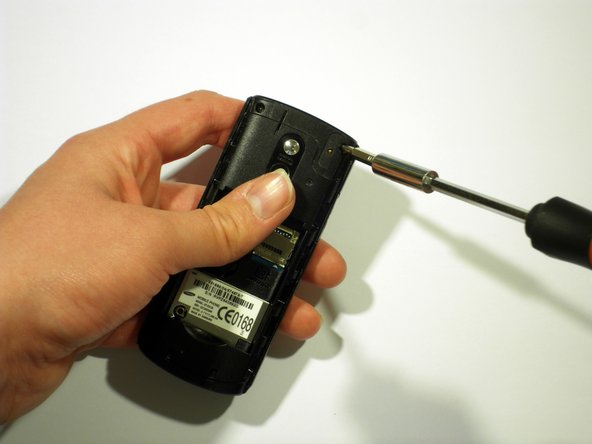

  • Next the screws were removed. These are Philips #00 size screws.

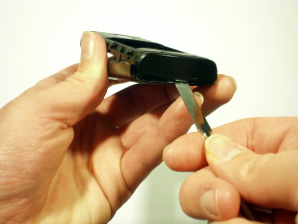

  • For this step a matal spudger was used to release the clips along the bottom, top, and sides of the phone.
  • These clips can be found at these point marked in red.
  • There may look like a lot of clips, but working from the top down, gently prying at the case they are easily dislodged.

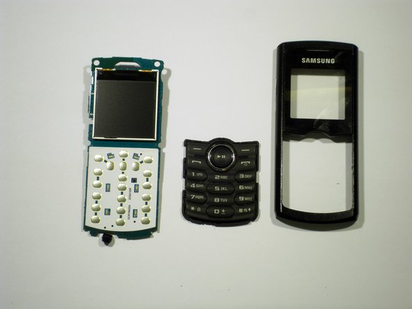

  • These are the two halves separated.
  • The camera located in the blue square is a VGA 640X480 resolution color camera.

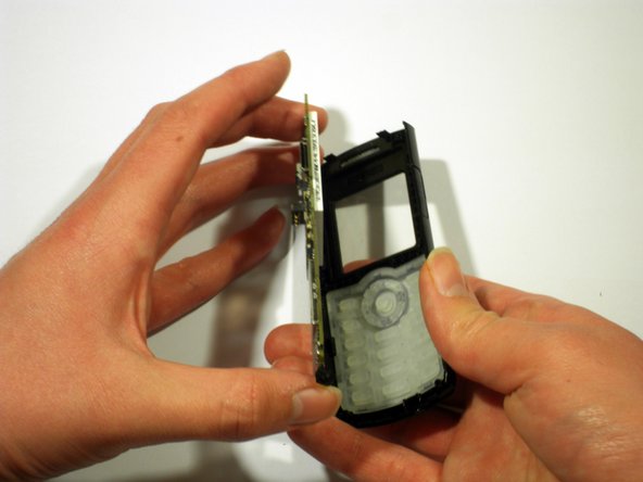

  • The microphone is carefully liffted up from its bracket, and the motherboard is carefully lifted out

  • The keyboard is then simply just pushed out!
  • The Phone includes a 65K CSTN color screen with a 128X128 resolution.
