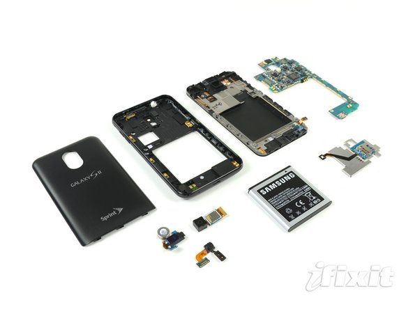

    • Break's over! A Phillips #00 screwdriver from our 54 piece bit driver kit and some plastic opening tools allow us to separate the rear case from the display assembly.
    • It's a good idea to work gently as you pry around the display glass. Excess force may result in, well, pokey shards of glass.
  6. Samsung Epic 4G Touch Teardown: step 6, image 1 of 2 Samsung Epic 4G Touch Teardown: step 6, image 2 of 2
    • After freeing a few more Phillips #00 screws, a handful of connectors, and a sticker from the firm grips of the Epic 4G's Touch, off comes the motherboard.
    • Cool your soldering stations everybody, we are pleased to announce that the device doesn't house a smorgasbord of EMI shields and that its single EMI shield is removable with only a few gentle pries.

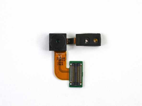

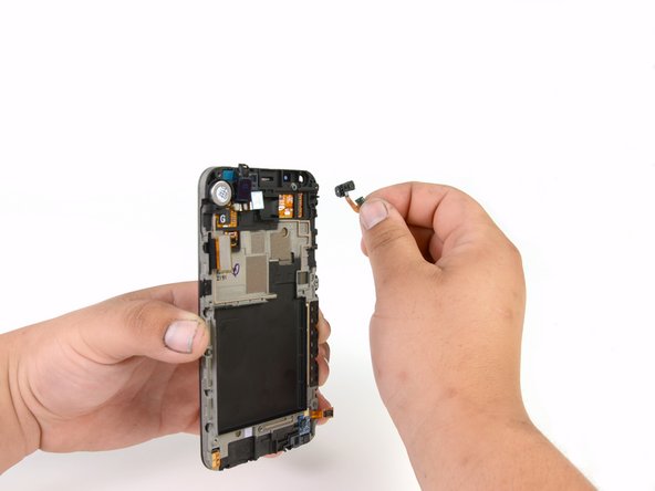

    • Pesky screws! As soon as you are all gone, the front-facing camera shall be freed.
    • Huzzah! Alas the front-facing camera gains its independence from the innards of the Epic 4G Touch.
    • The front-facing camera assembly is paired along with what seems to be the LED/ambient light sensor.

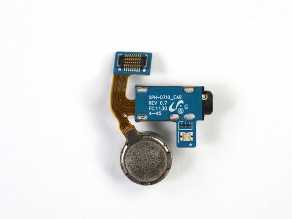

  10. Samsung Epic 4G Touch Teardown: step 10, image 1 of 3 Samsung Epic 4G Touch Teardown: step 10, image 2 of 3 Samsung Epic 4G Touch Teardown: step 10, image 3 of 3

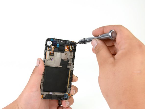

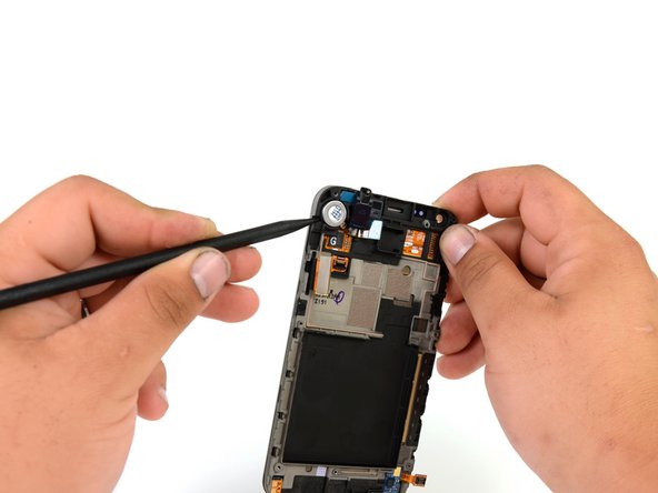

    • Gentle prying allowed the headphone jack and vibrator motor to be freed from the rear inner framework.
    • The vibrator motor is labeled 36CZB8QADHF.
    • The headphone jack/vibrator motor assembly is manufactured by Samsung, labeled as SPH-D710_EAR.

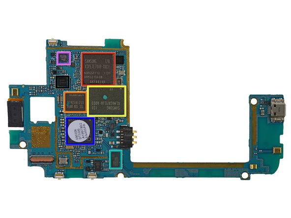

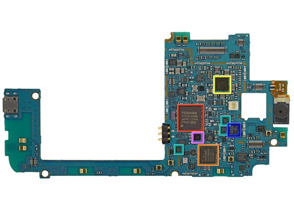

    • The front side of the motherboard contains the following major chips:
    • Toshiba TC31501AAMBG WiMax package. According to Chipworks, "This device operates in the 2.5GHz frequency band and offers high-speed connectivity in the mobile environment with low power consumption." (Thanks guys!)
    • Broadcom BCM4330XKFFBG 802.11 a/b/g/n MAC/Baseband/Radio with Integrated Bluetooth 4.0+HS and FM Transceiver/Receiver
    • Maxim MAX8997 Power Management IC
    • WIP4255H
    • Avago CFI120 223713
    • Maxim MAX8893C Power Management IC
  12. Samsung Epic 4G Touch Teardown: step 12, image 1 of 1
    • We continue identifying the chips located on the rear-side of the motherboard:
    • Samsung K3PE7E700B-XXC1 Dual-Core 1.2 GHz Processor
    • Samsung Electronics Corporation (SEC) K521H12ACE
    • Samsung KLMAG4FEJA-A003 16 GB Flash Memory
    • Avago ACFM-7325 Band Class 14 PCS/Band Class 10 Cellular Band Quadplexer
    • Qualcomm QSC6085 CDMA Processor
    • Silicon Image 924480
    • Yamaha YMU823 Audio Codec
