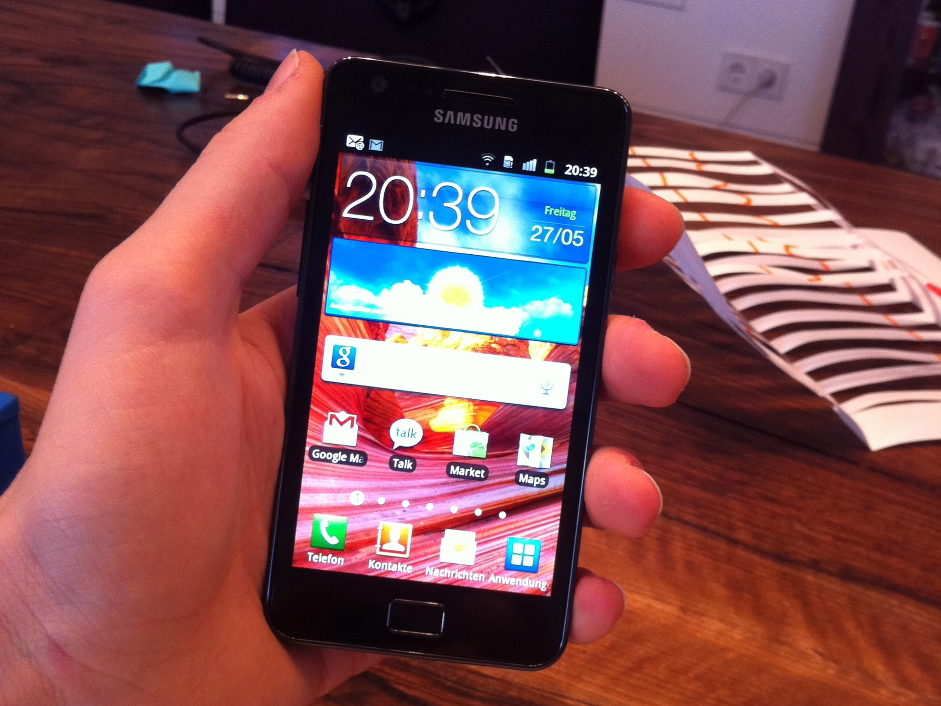

  • The 4.3-inch super Amoled Plus display is simply gorgeous!
