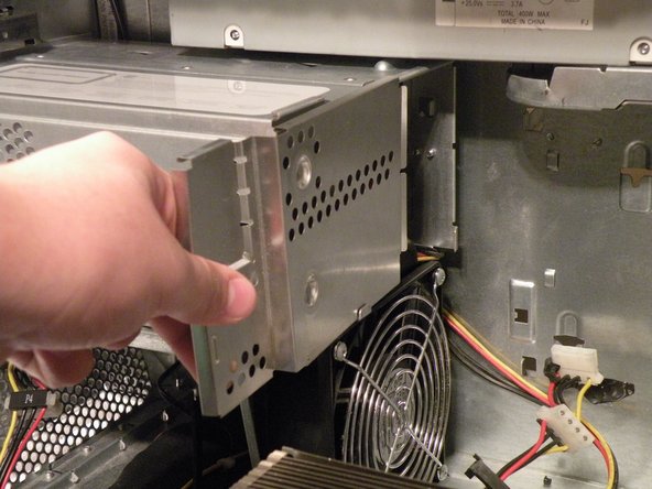

Image #1 Image #2 Image #3

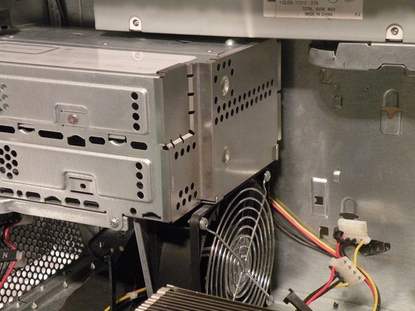

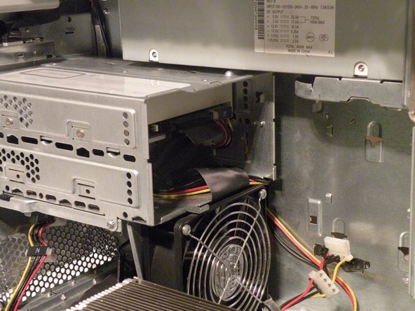

Add Note Edit Step 12  ¶
  • With the clip free, pull on this tab, lift the cage up, until it clicks, and pull it away.
  • Now, set the cage on top of the CPU, and remove the power connectors.
Image #1 Image #2
Add Note Edit Step 13  ¶
  • Once the cables are free, set the drive cage aside.
  • To remove the hard drives from the cages, remove the four screws on the sides of the cage that are connected to the drives, than slide the drives out.
  • The two cages are cross compatible and can be put in either rack.
  • The MDD does not have a 128GB drive limit like older macs, My MDD has 3 Drives (A 400GB Hitatchi Deskstar, 40GB Seagate Baracuda 7200.7, and a 30GB Quantum Fireball LCT).
  • Note the ID jumpers on the two drive set. One is set to Master, the other to slave. A single drive can be set to Cable Select.

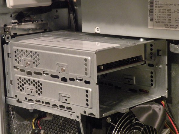

Add Note Edit Step 14 — Optical Drive Cage  ¶
  • Start removing the optical drive cage by removing the back cover.

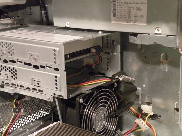

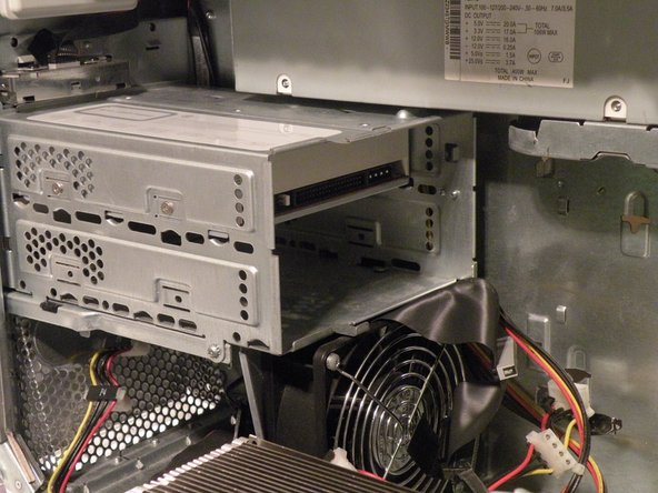

Add Note Edit Step 15  ¶
  • Now, remove the IDE and power cables.

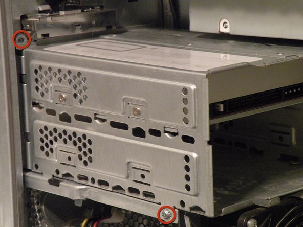

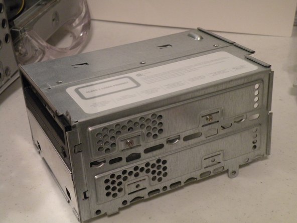

Add Note Edit Step 16  ¶
  • Remove these two Phillips screws:
  • Now, pull the cage away from the front until it is free.
  • Now, lift the cage out.
