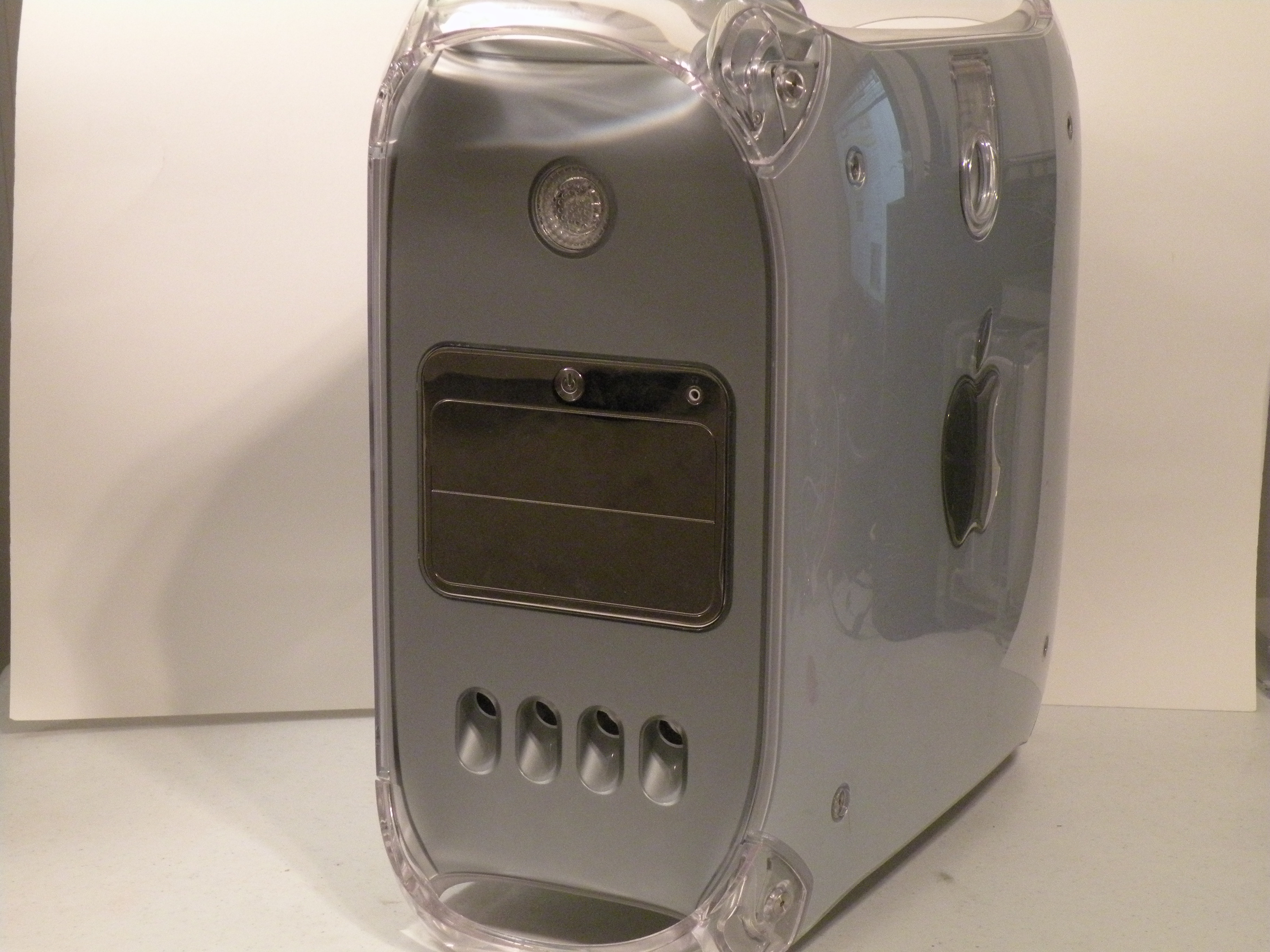

Add Note Edit Step 36 — Powermac G4 MDD (Mirrored Drive Doors) Teardown  ¶
  • The Powermac G4 MDD's, Guts Spilled On My Desk:
Image #1
