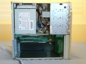

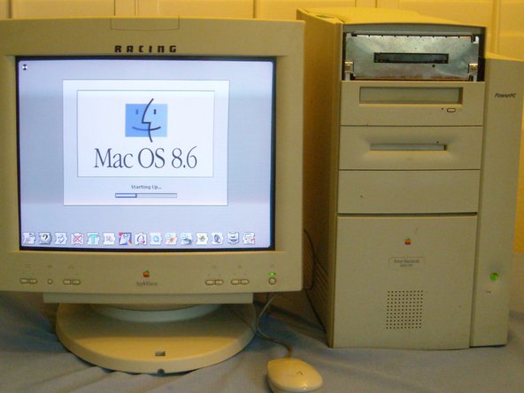

  1. Power Macintosh 8600(250) Teardown, Power Macintosh 8600(250) Teardown: step 1, image 1 of 1
    • There she is! i'm missing the bezel around the floppy drive :(

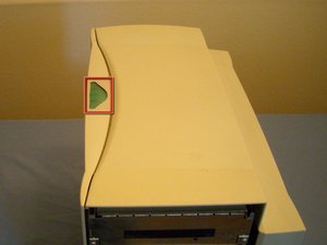

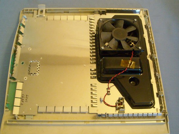

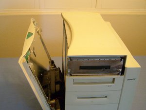

  2. Power Macintosh 8600(250) Teardown: step 2, image 1 of 3 Power Macintosh 8600(250) Teardown: step 2, image 2 of 3 Power Macintosh 8600(250) Teardown: step 2, image 3 of 3

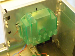

    • Start by pressing the big green button. And pulling the door away and up from the computer.
    • And on the Back of the door is the fan.

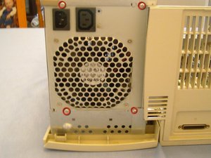

  4. Power Macintosh 8600(250) Teardown: step 4, image 1 of 1
    • The innards, motherboard, daughter board, RAM and so fourth.

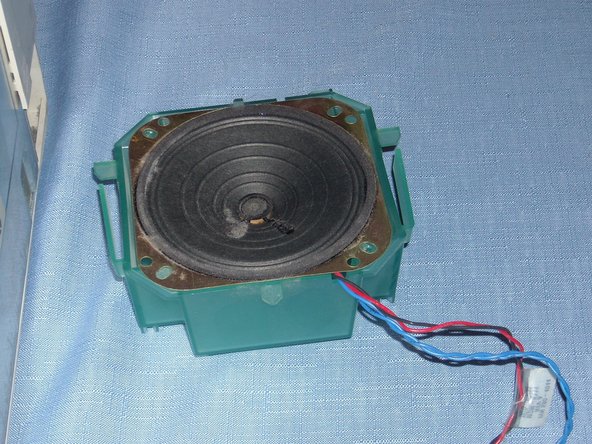

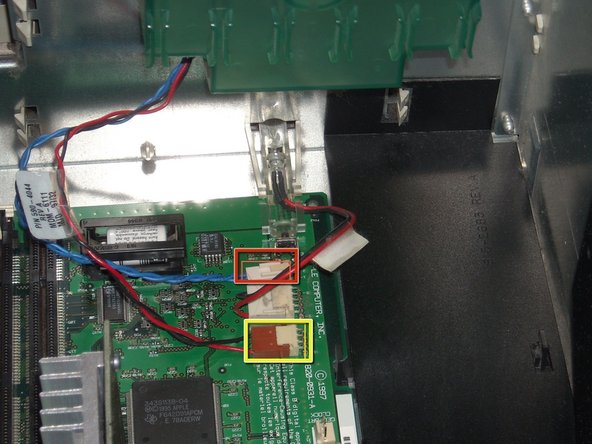

  5. Power Macintosh 8600(250) Teardown: step 5, image 1 of 3 Power Macintosh 8600(250) Teardown: step 5, image 2 of 3 Power Macintosh 8600(250) Teardown: step 5, image 3 of 3
    • Now the speaker
    • Remove the speaker wires
    • And the fan wires from the motherboard
    • Push in the two plastic tabs on either side and lift the speaker up and out.

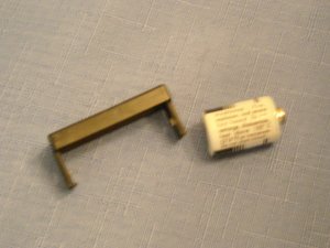

  6. Power Macintosh 8600(250) Teardown: step 6, image 1 of 2 Power Macintosh 8600(250) Teardown: step 6, image 2 of 2
    • The PRAM battery!
    • Remove the housing by pulling it out and then take the battery out.

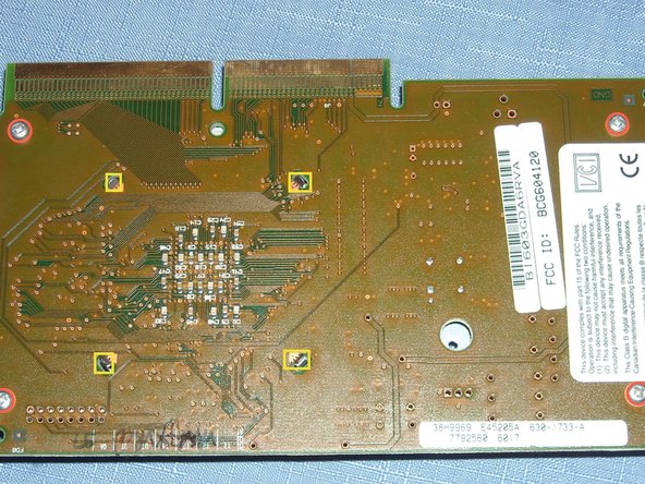

    • The processor, firmly grasp and pull out.
    • Remove the 4 #1 Phillips screws
    • And push the 4 tabs off of the board

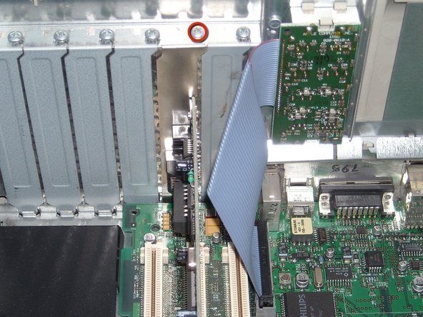

  8. Power Macintosh 8600(250) Teardown: step 8, image 1 of 1
    • Any video card or usb card, mine happens to be an ethernet 10/100 card.
    • Unfortunately there are 6 spaces but only 3 slots on the motherboard :(
    • Remove the #1 Phillips screw and pull the card out.

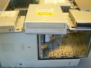

  9. Power Macintosh 8600(250) Teardown: step 9, image 1 of 1
    • RAM and VRAM slots!

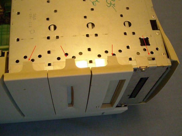

  10. Power Macintosh 8600(250) Teardown: step 10, image 1 of 3 Power Macintosh 8600(250) Teardown: step 10, image 2 of 3 Power Macintosh 8600(250) Teardown: step 10, image 3 of 3

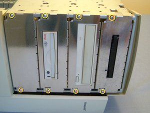

    • Moving on to the CD, ZIP, and Floppy drives (best to close computer now)
    • Remove the bezels and if I had the top one remove that too.
    • Remove the 6 phillips screws and pull the metal frames out.

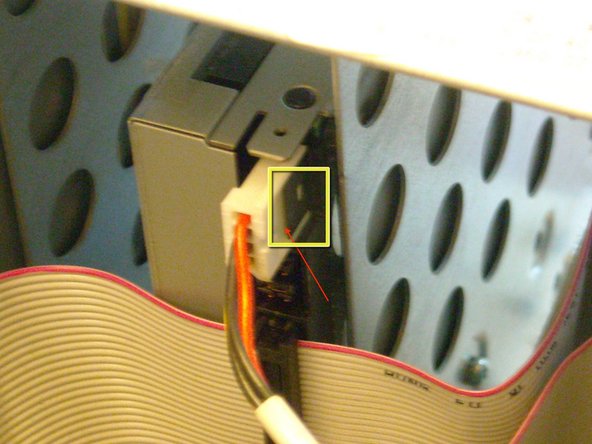

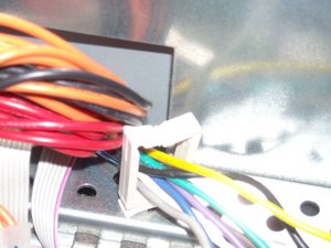

  11. Power Macintosh 8600(250) Teardown: step 11, image 1 of 3 Power Macintosh 8600(250) Teardown: step 11, image 2 of 3 Power Macintosh 8600(250) Teardown: step 11, image 3 of 3
    • Remove the data and power cables
    • Pay special attention to this one, it has a clip on it, it helps to use a flathead or a spudger.
    • Pull the drives out of the bay.

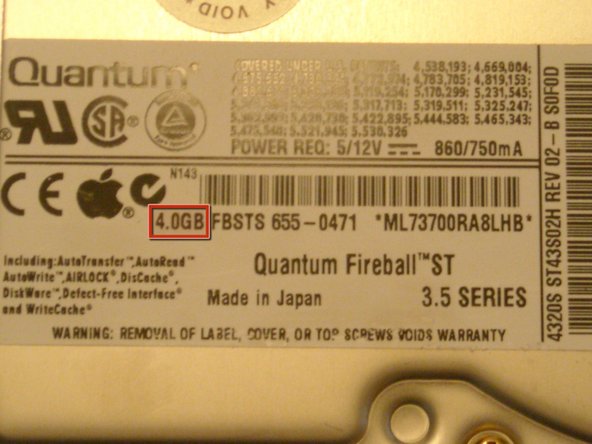

  12. Power Macintosh 8600(250) Teardown: step 12, image 1 of 2 Power Macintosh 8600(250) Teardown: step 12, image 2 of 2
    • Now the hard drive.
    • Remove the two phillips screws
    • And the data and power cables (might help to remove them as you pull the drive out)

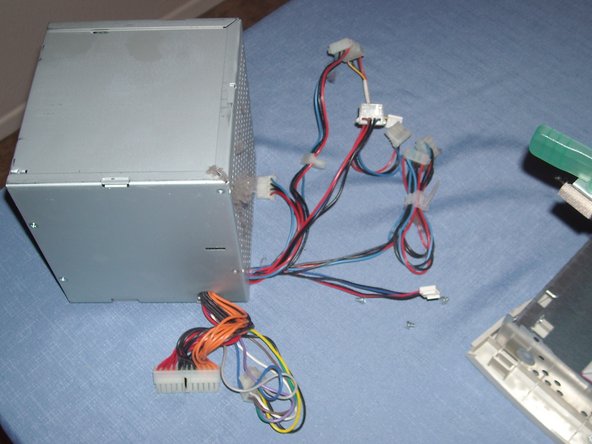

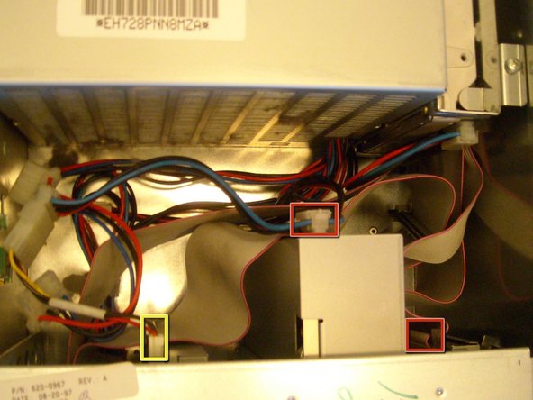

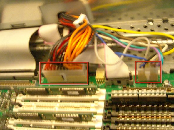

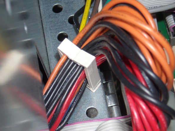

  13. Power Macintosh 8600(250) Teardown: step 13, image 1 of 3 Power Macintosh 8600(250) Teardown: step 13, image 2 of 3 Power Macintosh 8600(250) Teardown: step 13, image 3 of 3

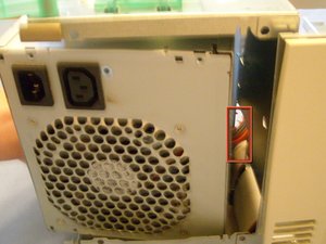

    • The power source
    • Remove the two connectors
    • There is a clip holding the wires in place. Separate and remove the wires. (both sets)

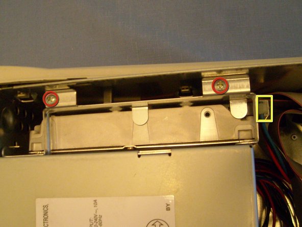

  14. Power Macintosh 8600(250) Teardown: step 14, image 1 of 3 Power Macintosh 8600(250) Teardown: step 14, image 2 of 3 Power Macintosh 8600(250) Teardown: step 14, image 3 of 3
    • Now remove the 4 phillips screws (it's best to start with the bottom two)
    • And pull it out while de-threading the wires.
