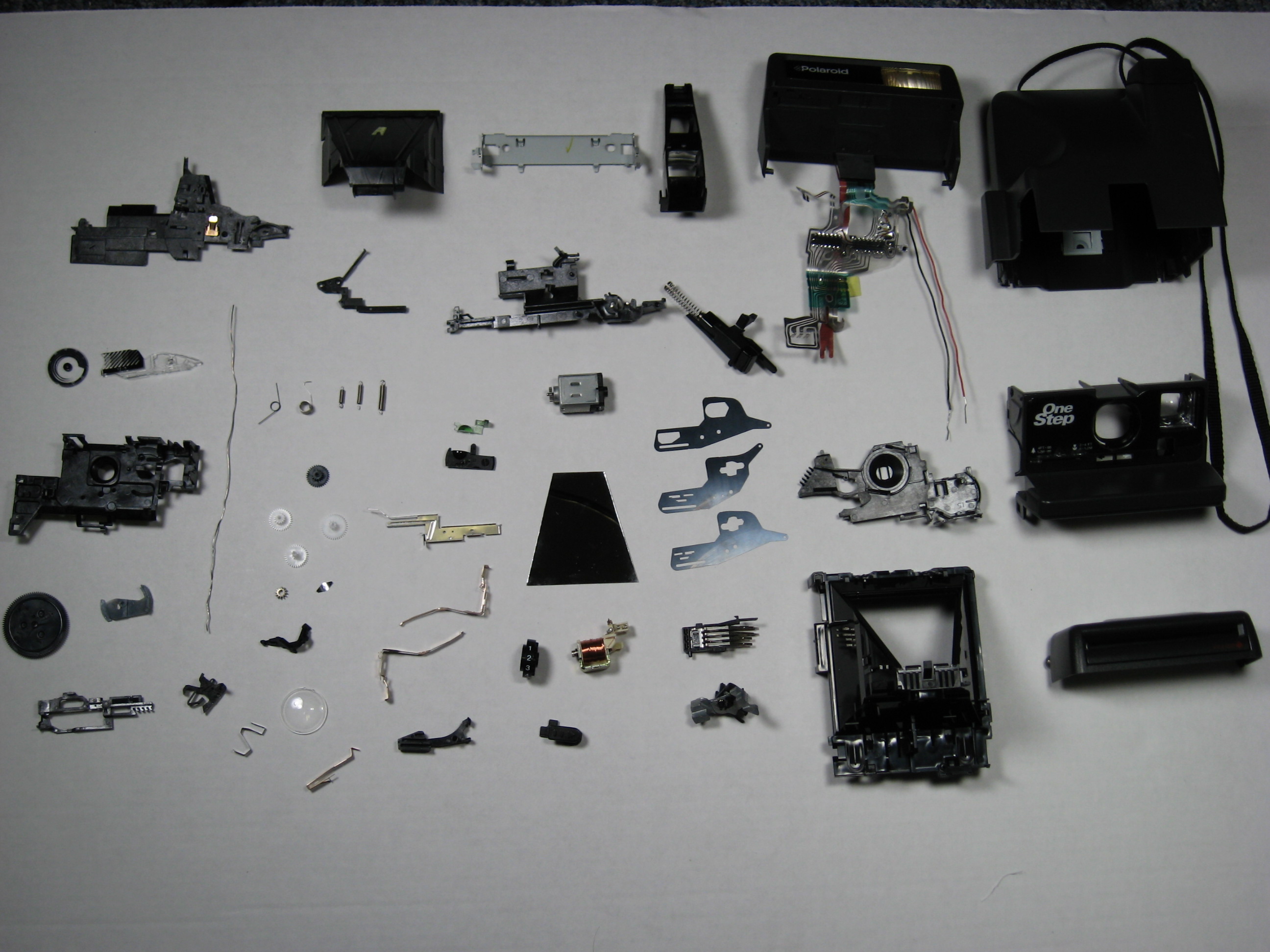

This guide shows you how to completely disassemble your camera.

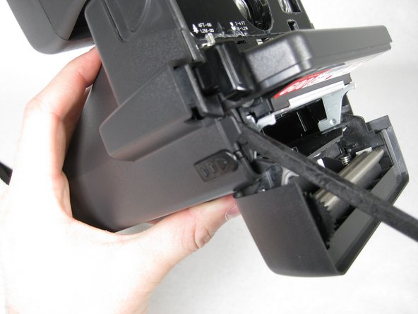

  • Open the flash/lens compartment of the Polaroid camera to a 30 degree angle with the horizontal.
Image #1 Image #2 Image #3
Add Note Edit Step 2  ¶

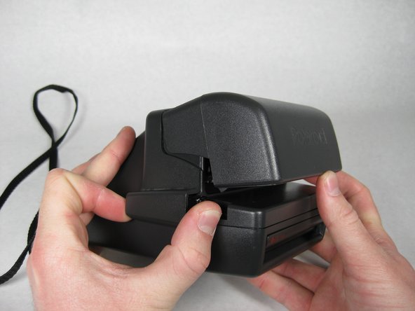

  • Separate the flash section of the camera from the main body by unhooking the sides.
  • BE CAREFUL NOT TO YANK THE TWO SECTIONS APART BECAUSE THE BAND WIRE STILL ATTACHES THEM!

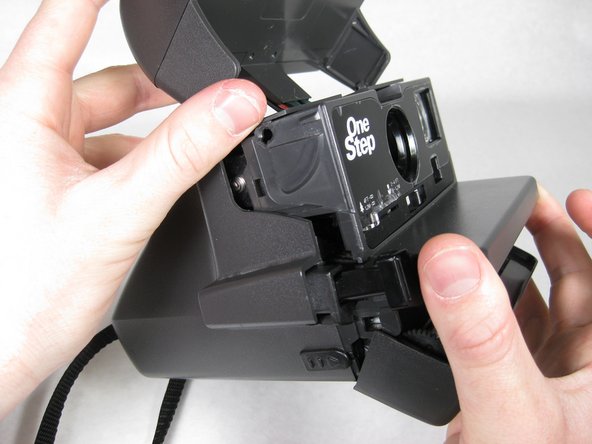

Add Note Edit Step 4  ¶

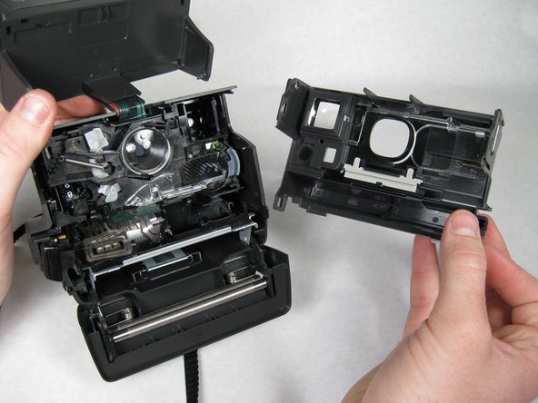

  • Insert spudger in between face of camera and sides where the four tabs are located.
Image #1 Image #2
Add Note Edit Step 5  ¶
  • Once tabs are released, pull face of camera straight out.
Image #1 Image #2

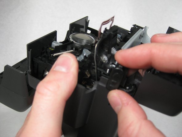

  • Remove the capture button if it did not pop out when you removed the face.
  • There are two pieces to the capture button and both should be removed.

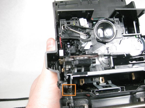

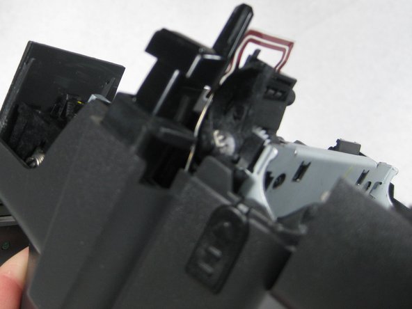

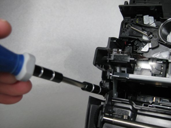

Add Note Edit Step 7  ¶

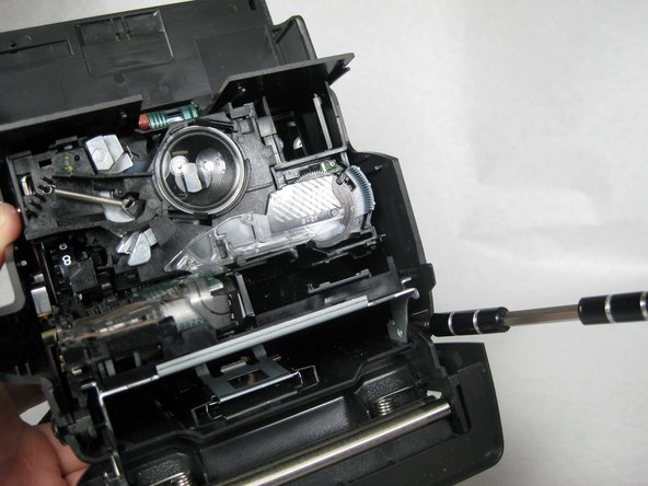

  • To remove the back of the camera, you have to find the tabs located near the hinges of the battery and film compartment.
  • Using a screw driver, pry the tabs of the outer case away from the metal frame.
  • Once the tabs are removed slide the metal frame forward.
Image #1 Image #2
Add Note Edit Step 8  ¶

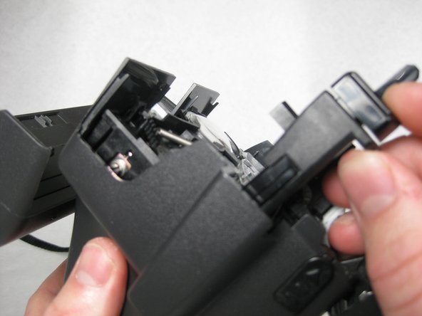

  • Remove the battery and film compartment latch
  • Pull the metal frame away from the case.
  • The entire case will come off but the flash compartment will come with the insides of the camera.
