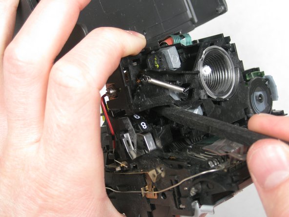

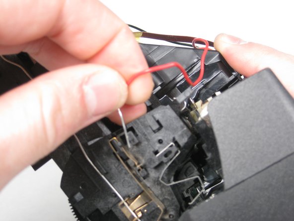

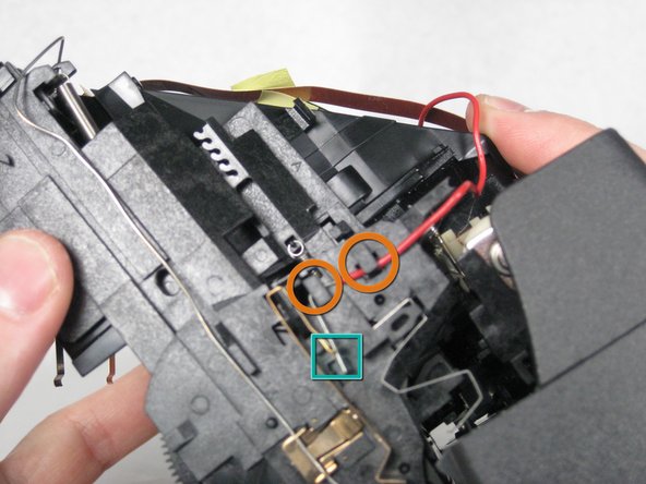

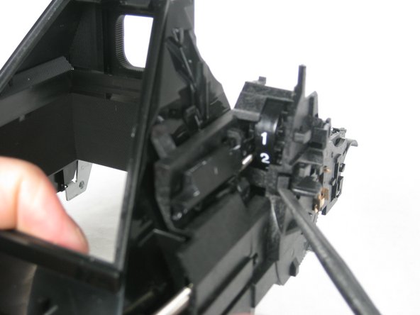

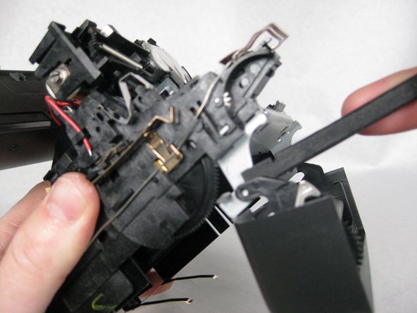

Add Note Edit Step 10  ¶
  • Remove the sight by lifting it straight up.
  • Follow the red wire from the flash compartment
  • Take the red wire off of the 2 hooks
  • Slide the uncovered wire end out of the small brass clip. Move wire away from camera.

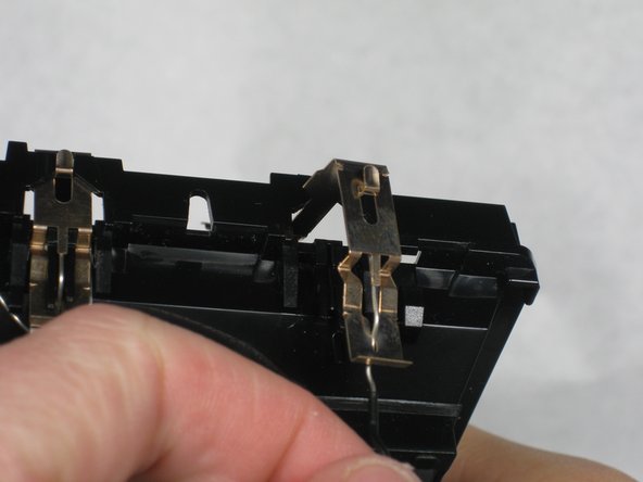

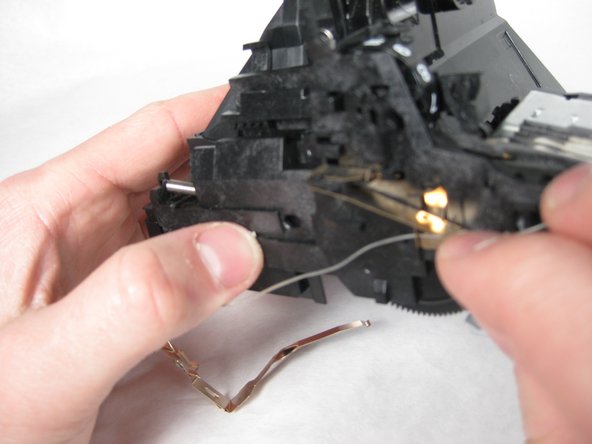

Add Note Edit Step 11  ¶

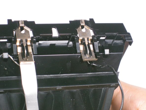

  • Follow the black wire from flash bulb to the back of the case.
  • When you find the brass tab, pull it up. When the tab is free, remove the tab from the black wire.
Image #1 Image #2 Image #3

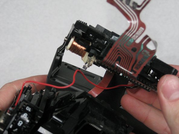

Add Note Edit Step 13  ¶
  • Slide the brightness adjuster to right and off the camera.

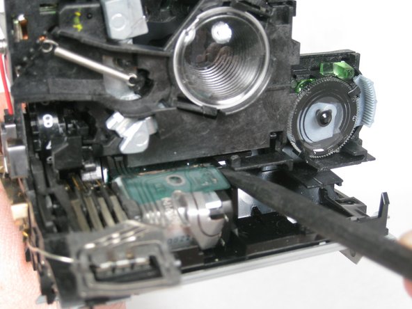

  • Use the pointed end of the spudger to lift a small latch located next to the bottom of lenz plate
  • Then find the small latch located below the plastic bridge that is over the shutter mechanism
  • This latch is small and is hard to see but you just have to push it with the pointed end of the spudger to unlatch it.

Add Note Edit Step 14  ¶
  • Using the pointed end of the spudger, pull the band wire out of the electric motor.
  • In the same manner as above, remove the band wire from the plastic extension.

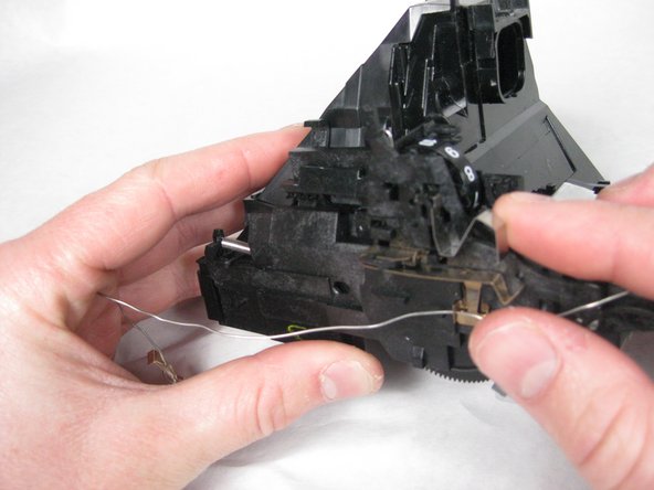

Add Note Edit Step 16  ¶

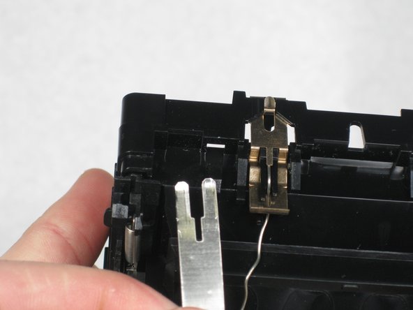

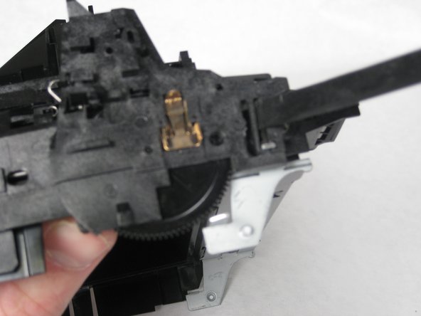

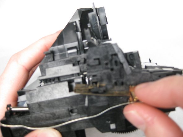

  • Follow the uncovered wire around the side of the camera
  • Remove the metal spring tab next to the counter
  • Remove the brass tab by lifting the top piece over the notch and sliding back.

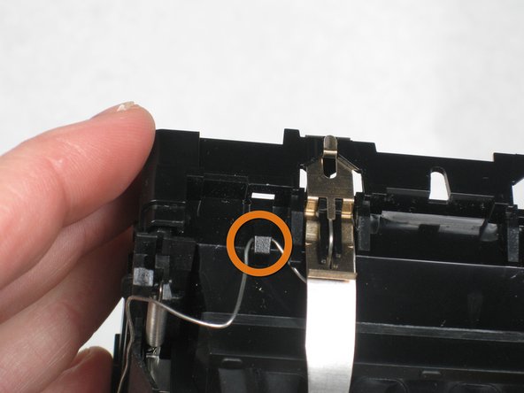

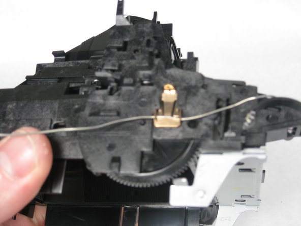

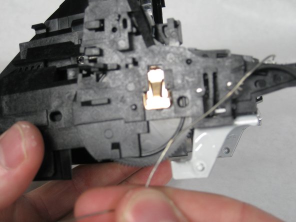

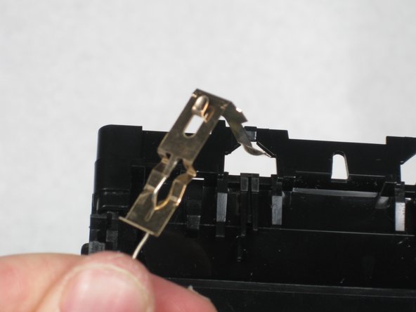

Add Note Edit Step 17  ¶
  • Locate the small brass tab with the uncovered wire running through it.
  • Remove the wire by sliding under the hooks.
  • then unhook the uncovered wire from the the final latch located on the top of the plastic extension.
Image #1 Image #2

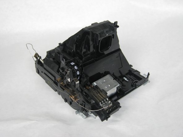

Add Note Edit Step 18  ¶
  • The cameras insides could now be in two major pieces.
  • The Pyramid and the lens plate

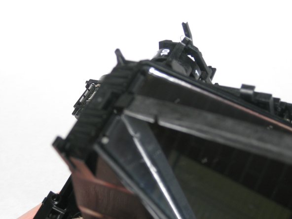

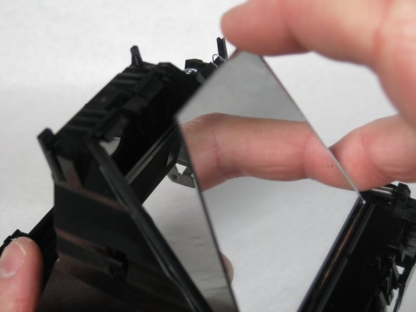

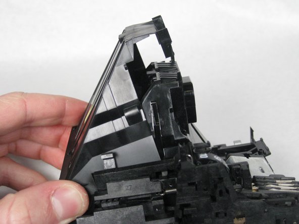

Add Note Edit Step 19  ¶
  • The top of the pyramid has cover that can be lifted off
  • Below is the mirror which is held in by a tab.
  • Lift the tab with the spudger and pop out the mirror.
  • If you intend to reassemble the camera make sure the mirror is completely clean without any spots or fingerprints because they will affect the quality of your pictures.

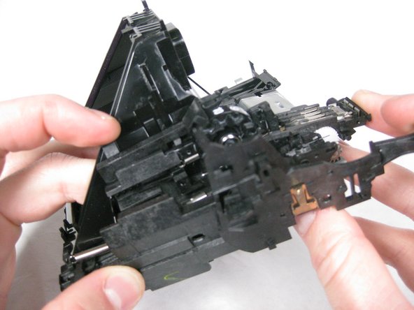

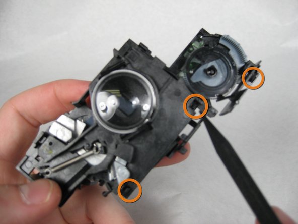

  • There are 4 tabs total that must be removed for the next step
  • The first is directly under the spring mounted at the back left of the camera
  • The next is located on the front of the plastic extension
  • The third tab is used to connect the metal frame to the outer plastic
Image #1 Image #2
Add Note Edit Step 21  ¶

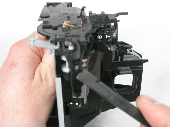

  • The final tab holds several spring loaded pieces together, these may pop out the moment the tab is released.
  • The final tab is located below the backside of the photo-counter dial.
  • The numbers will be right side up if you are looking in the right direction.
  • Once all four tabs are removed the plate pulls out from the slot in the rear.

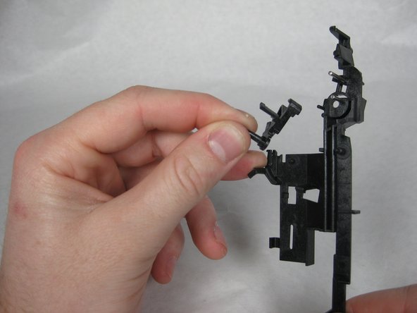

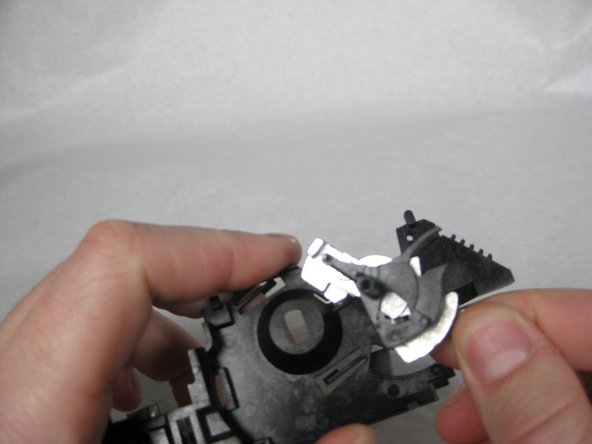

Add Note Edit Step 22  ¶

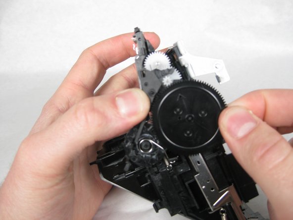

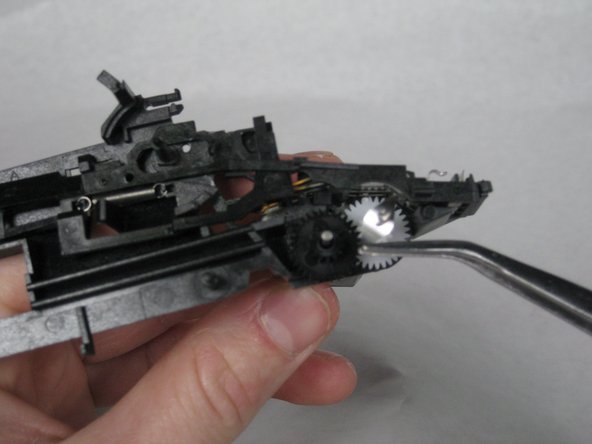

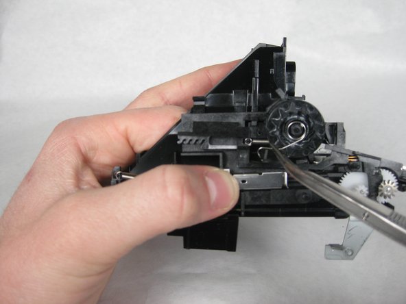

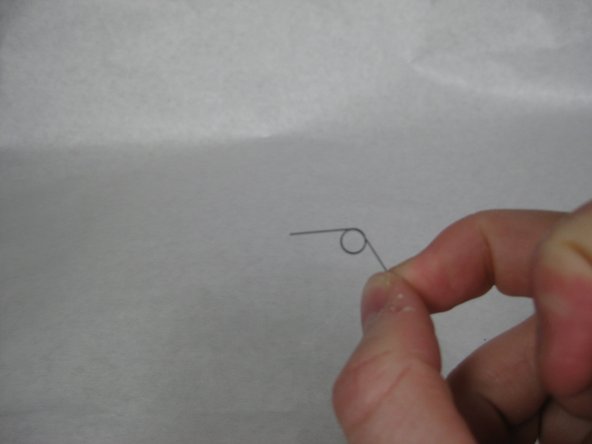

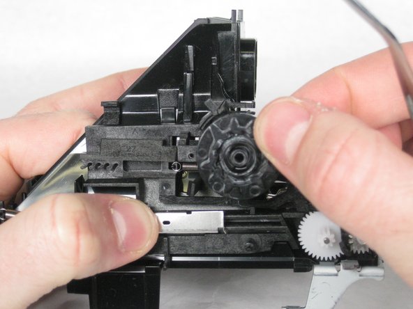

  • Lift the large gear away from its pin
  • The next piece is loaded with a small spring.
  • Carefully lift the "Y" shaped plastic piece from its pin and pull the spring from the pin as it is removed.
Image #1 Image #2

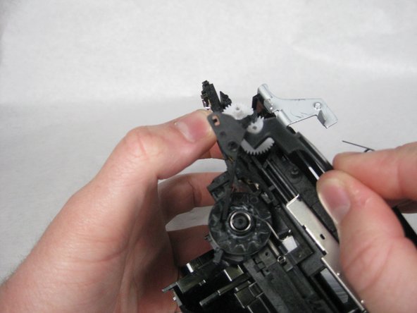

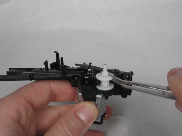

Add Note Edit Step 26  ¶
  • Remove the metal gear from the gear set.
  • Pull the "L" shaped black plastic piece off of its pin.
Image #1 Image #2

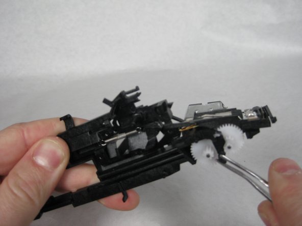

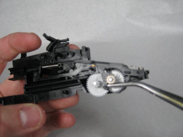

Add Note Edit Step 27  ¶
  • There are four gears to remove.
  • The gear on the left goes first, followed by the the right.
  • The right gear has a small leaf spring between it and the gear below it.
  • Then remove the black gear and then the last white gear.

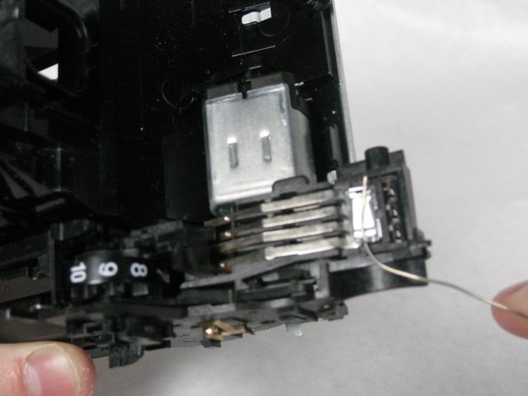

Add Note Edit Step 28  ¶

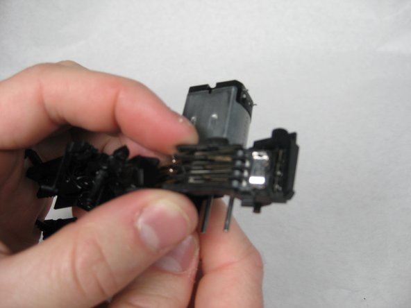

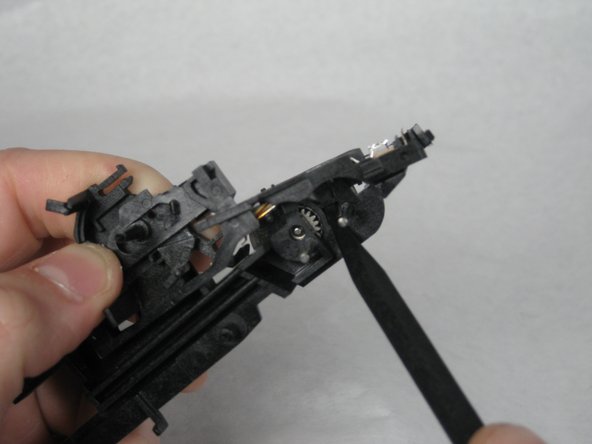

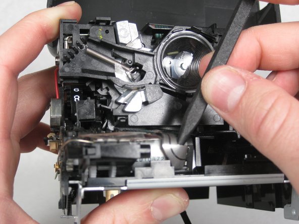

  • Using the pointed end of the spudger, press the clip that is beneath all the gears next to the electric motor gear.
  • Lift the plastic box containing several long metal tabs
  • Then slide the box out.
Image #1

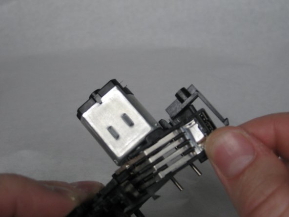

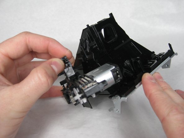

Add Note Edit Step 29  ¶

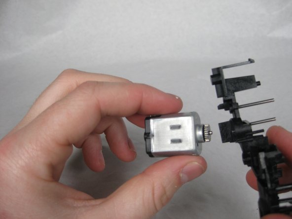

  • Pull the electric motor straight out of the plastic piece.

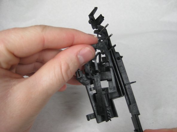

Add Note Edit Step 30  ¶

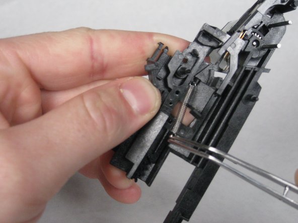

  • Remove the spring located in the middle of the plastic mechanism.
  • Remove the two loose plastic pieces.
Image #1

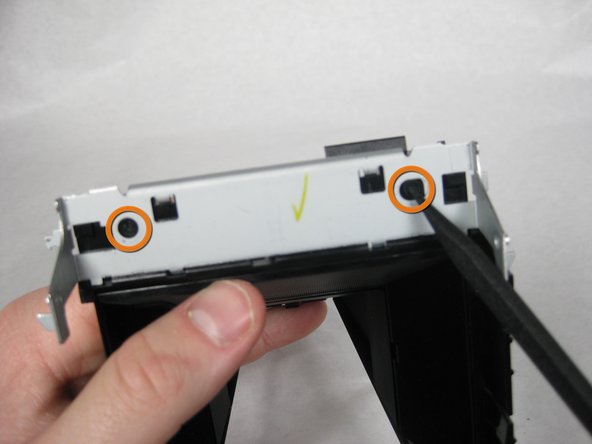

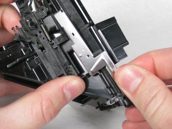

Add Note Edit Step 31  ¶

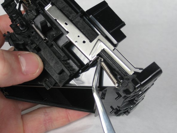

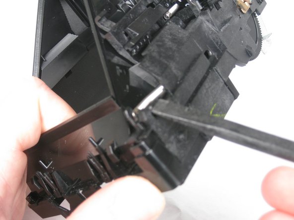

  • To remove the metal frame, press the two tabs with the spudger and slide it forward.
Image #1 Image #2

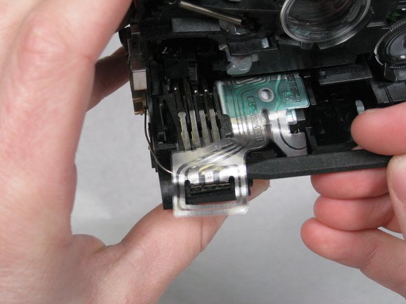

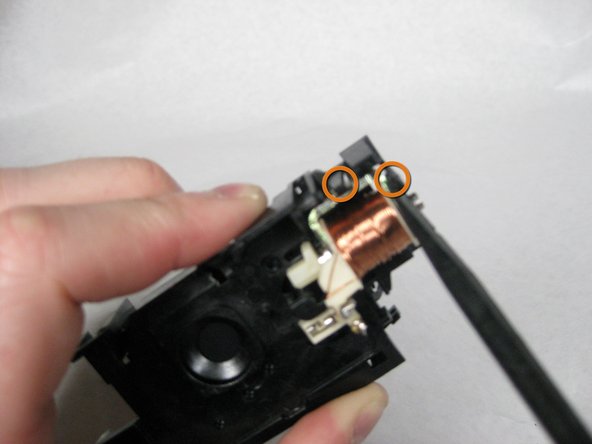

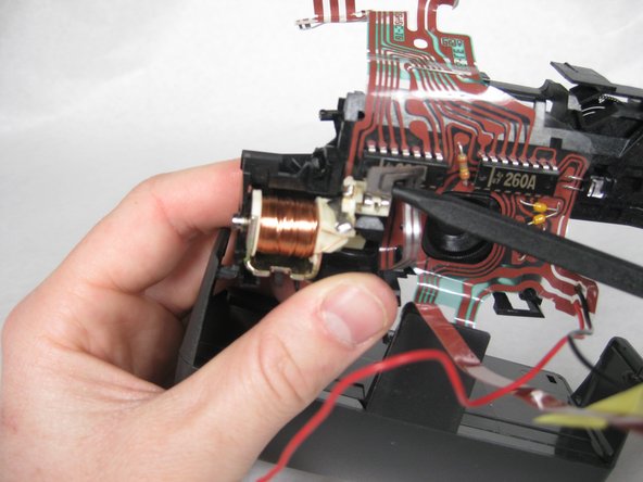

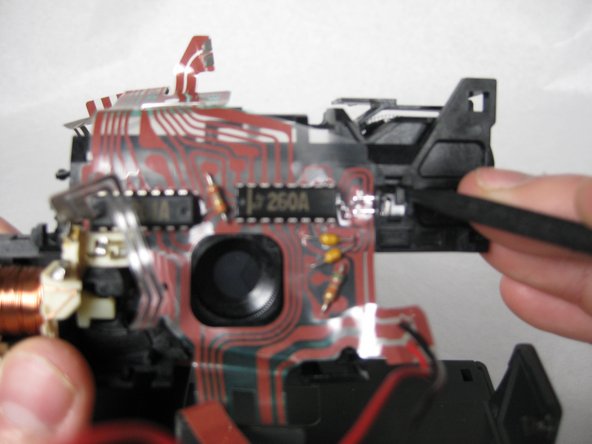

Add Note Edit Step 32  ¶

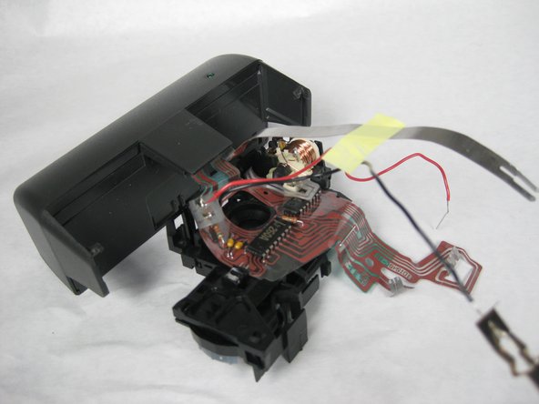

  • With the point of the spudger, remove the band wire from the solenoid.
  • Remove the small LED from its clip, and then lift the flat wire array and the flash compartment away from the back of the lens plate.
Image #1
Add Note Edit Step 33  ¶
  • Remove the solenoid from the back of the lens plate by removing the two tabs.
Image #1 Image #2

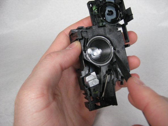

Add Note Edit Step 34  ¶
  • Remove the lens by pressing the tab.
  • CAUTION: The lens may pop out when the tab is released.
  • Remove the back of the lens plate by unhooking the three clips that hold it together.
  • CAUTION: The Shutter leaves may fall out during this step.

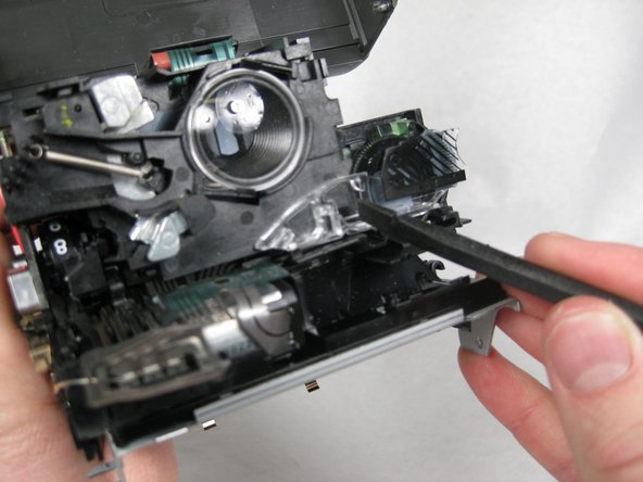

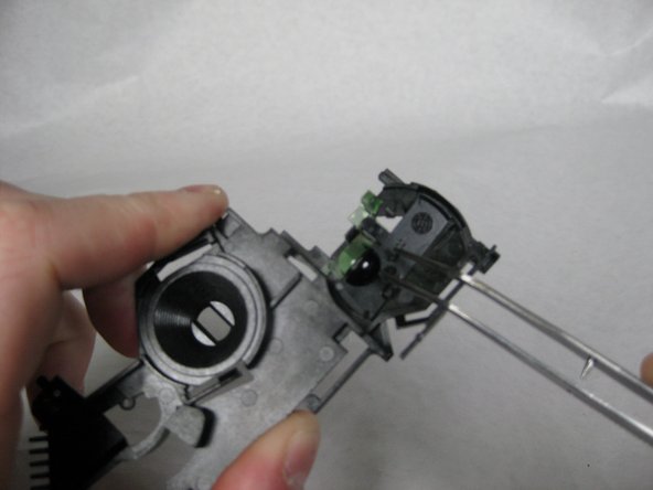

Add Note Edit Step 36  ¶

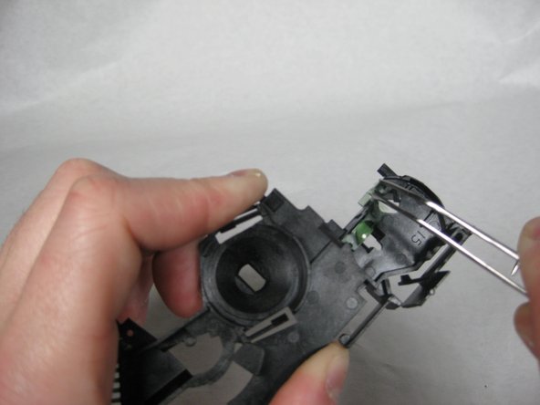

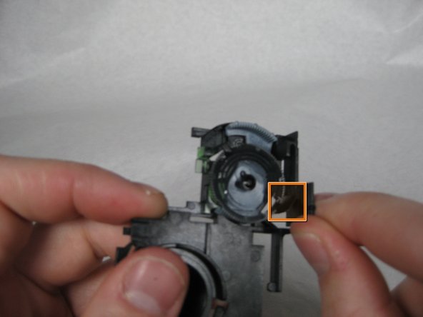

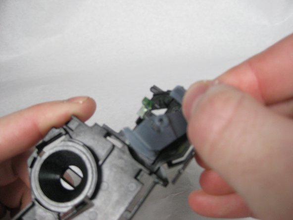

  • Remove the Clear dial by unhooking the tab at the bottom of the dial
  • Lift the light blue piece out of the mechanism.
  • Lift the black piece out of the plastic plate.
Image #1
Add Note Edit Step 37  ¶
  • Remove the clear green prism from the plastic plate.
Image #1

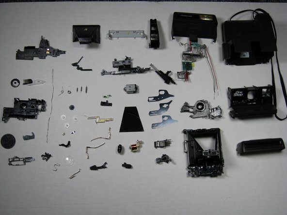

Add Note Edit Step 38  ¶
  • The disassembled camera.
