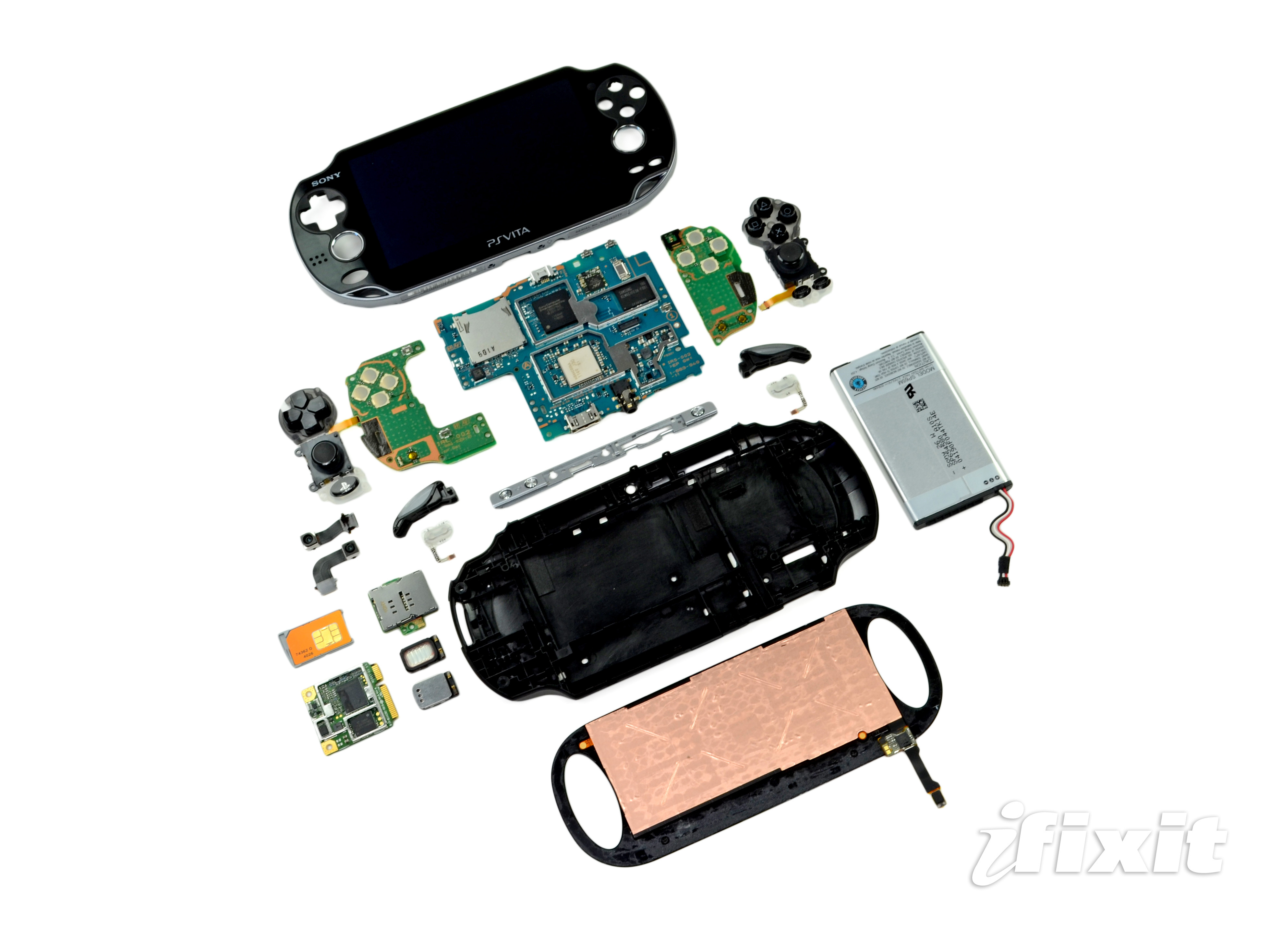

    • With the motherboard finally all by itself, we can begin chip identification:
    • Sony CXD5315GG quad-core processor + system memory
    • Samsung KLM4G1FE3A-F001 NAND flash memory
    • Fujitsu MB44C026A
    • Marvell 88W878S-BKB2 Avastar WLAN/Bluetooth/FM Single-Chip SoC
    • Wolfson Micro WM1803E audio codec
    • STMicroelectronics 3GA51H gyroscope
    • Kionix KXTC9 three-axis MEMS accelerometer

  23. PlayStation Vita Teardown: step 23, image 1 of 2 PlayStation Vita Teardown: step 23, image 2 of 2
    • After much deliberation, the council of iFixit has deemed appropriate a reparability score of 8 out of 10.
    • All screws are standard Phillips #00. No security or proprietary bits here.
    • Modular design means lower repair costs because small parts can be replaced individually.
    • Only one component was held in place with adhesive: the rear touch panel.
    • Battery is not easily accessible, but it is definitely serviceable by the average user armed with the appropriate screwdriver.
    • The front plastic is fused to the OLED (and difficult to separate from the frame), making replacement of the display more expensive.
