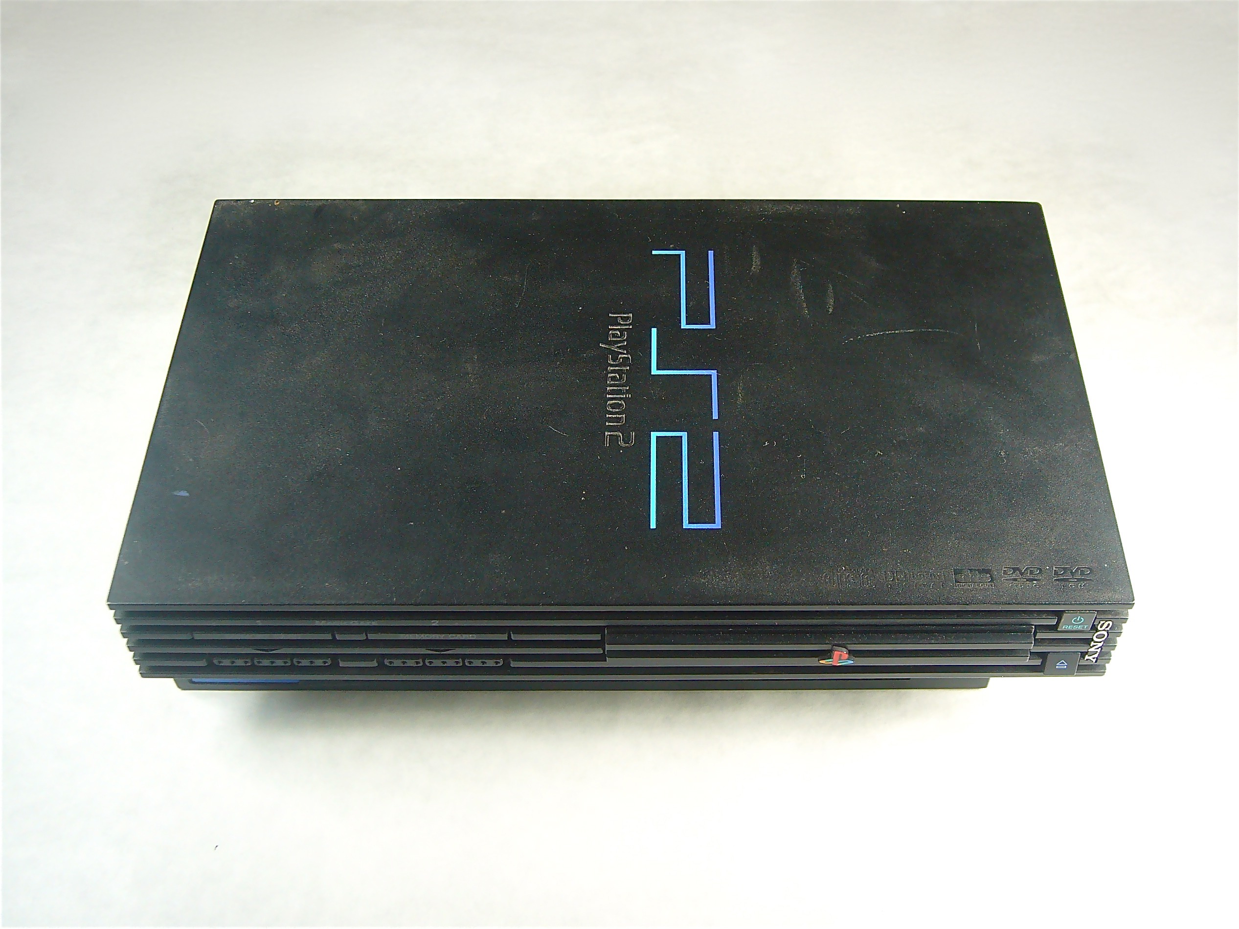

This guide will show you how to take your PlayStation 2 apart, down to the bare bones.

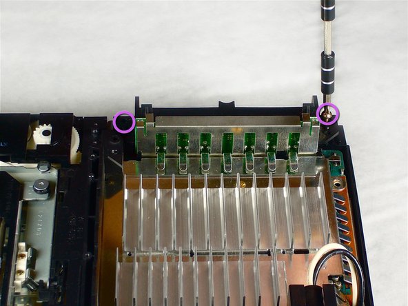

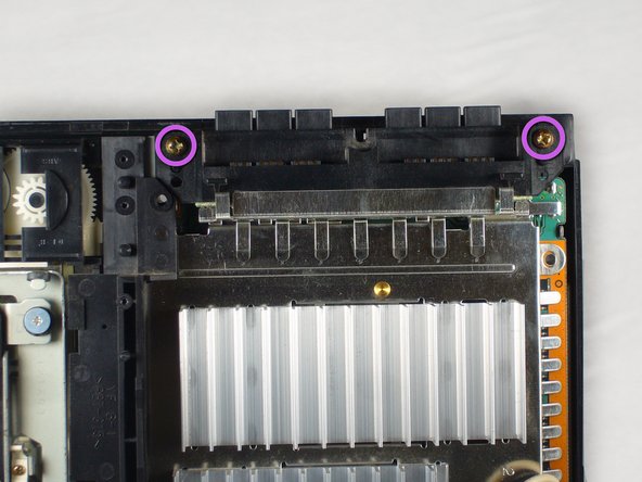

Add Note Edit Step 6  ¶
  • Remove two 14.6mm Phillips head gold screws to remove controller port.

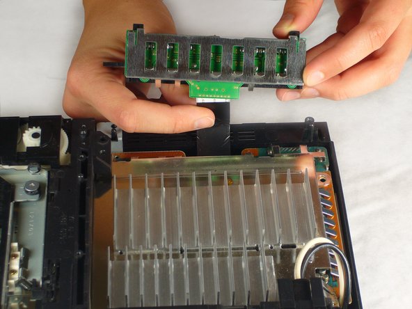

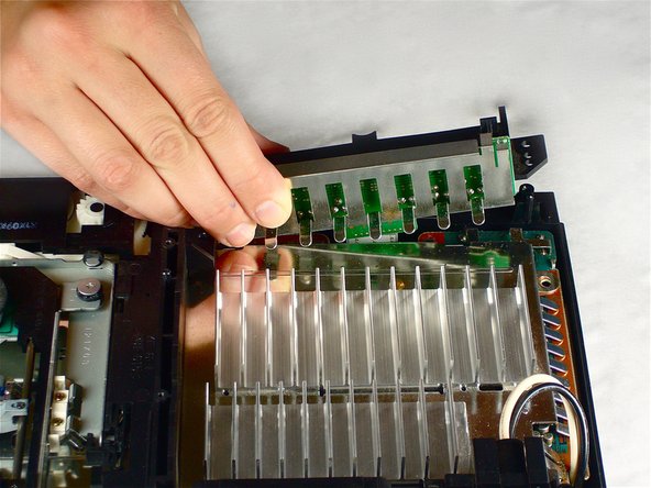

Add Note Edit Step 7  ¶
  • Gently lift out the controller port.
  • Remove the ribbon cable.

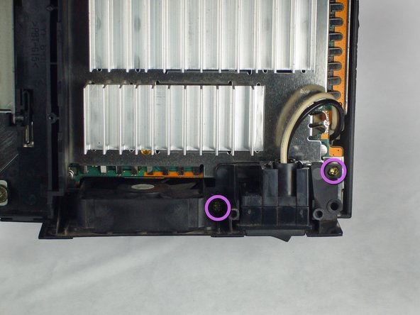

Add Note Edit Step 8  ¶
  • Remove two 14.6mm Phillips head gold screws holding the fan.
