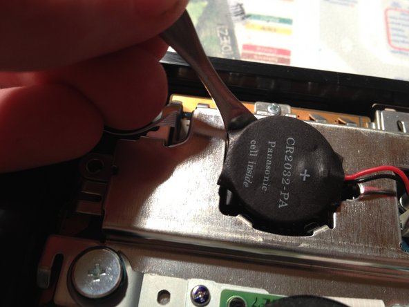

  • When the chassis is open you see the motherboard with everything attached.
  • First remove the battery. Use a spudger to pry it out and pull the cable from the motherboard.

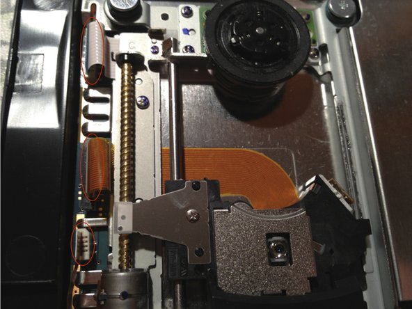

  • Three cables connect the optical drive to the motherboard. Just pull the flex cable out of the socket.
  • Take a PH01 screwdriver to remove the four screws of the optical drive.
  • Pull up the optical drive and try to peel the flex cable attached underneath the drive from the metal plate.

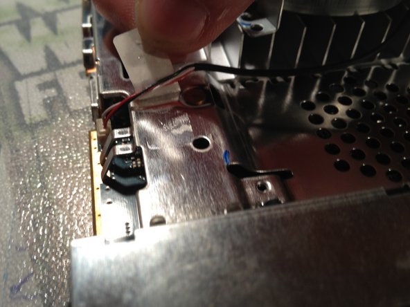

  • The fan is secured with three PH00 screws. Remove them.
  • Next peel up the duct tape and remove the cable.

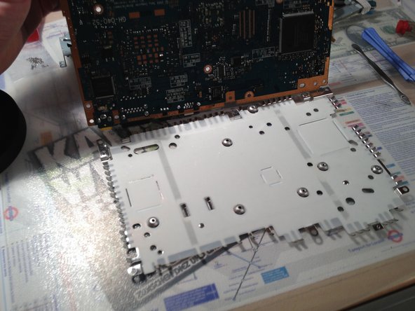

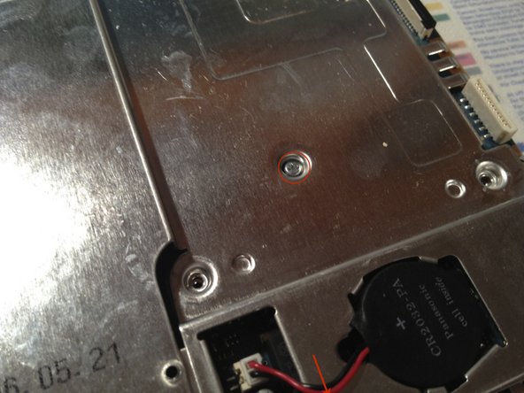

  • Remove the four screws marked on the picture. They are located on the downside of the motherboard, so you have to turn it.
  • Then flip it again and remove the two rating screws on the upside.
  • Now both metal plates should be ready to remove.
Image #1 Image #2
Add Note Edit Step 7  ¶

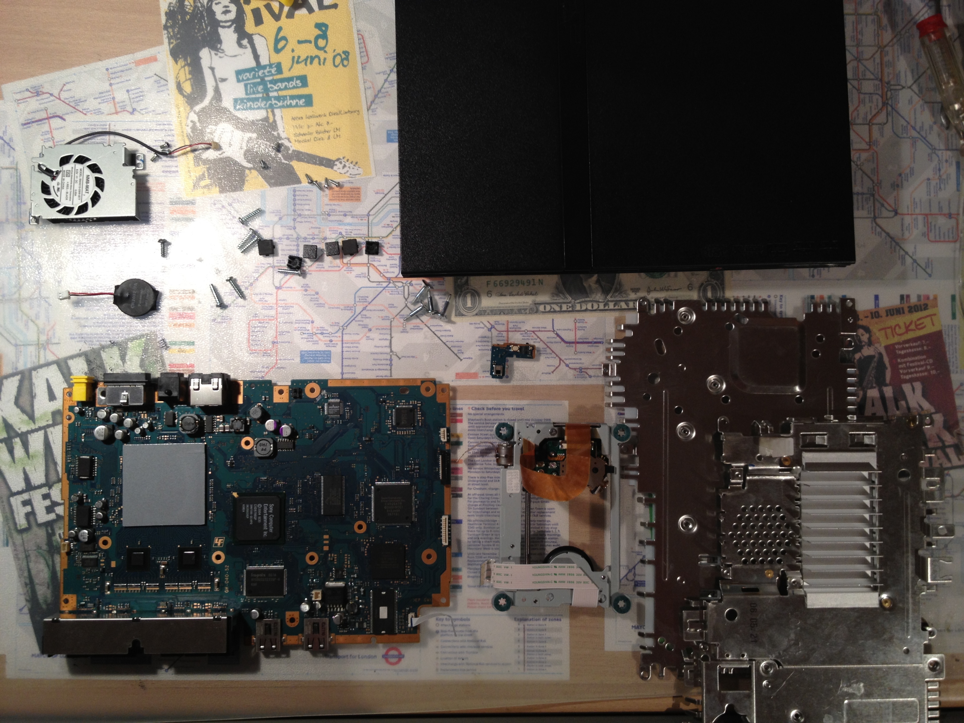

  • Remove the downside metal plate.
  • Now everything should be disconnected and you have your PS2 Slimline successfully torn down.
